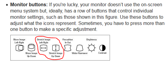

Aspect ratios are a function of your monitor not AutoCAD well at least since the days of DOS.
Don't you have buttons on the front of your monitor that control the various settings? If not then perhaps your monitor controls these settings via software.
Do you have a CRT or an LCD monitor? By the way, what are you using as a screen resolution (ex. - 800x600 or 1024x764)? Just curious.
This is what you want to adjust.
Edited by ReMark

ReMark: Thanks for your reply. I have an AOC LCD monitor - screen res = 1280x1028. It does have buttons for monitor control, but pressing them singly, in sequence, simultaneously, or one at a time results in no action at all. One of the buttons looks like it might address the problem, but nothing happens when I press it. I think I would like to get the width-to-height ratio to 1:1 as this would probably make all the icons on the desktop which are supposedly circular but display as ellipses go back to circular. Again thanks for your input. If you can think of anything else I might try - reload driver (2008 version), etc, give me a holler. joewillie

What model AOC LCD do you have? The buttons should be explained in your monitor's documentation.
