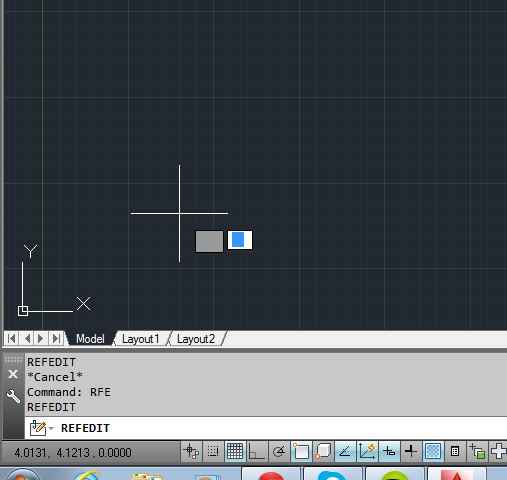

Hello folks! I have a wierd problem with Refedir command. After typing REFEDIT it doesnt prompt selection as usual, it asks for some input next cursor as on attached image. It does the same with preselection. I tried to enter name of the block but it also didn`t work. Any ideas what it possible wants?refedit prompt.png
Note: In the DOC window opening each time for a half of second after exiting the commant I was able to read this line: command is not recognized as an internal or external autocad

Hit your f2 key to expand the command line to a text window. Then you can see if there are any other messages in the response you are getting from the refedit command.
Are your xref layers locked, or otherwise restricted by any chance?
