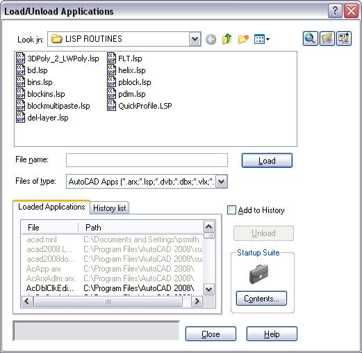

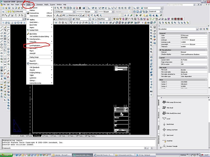

skipsophrenic Posted December 16, 2008 Posted December 16, 2008 LOL Try this. this code http://www.cadtutor.net/forum/showthread.php?t=2019 (written by Eduad Smoljanka) instead Express Tools flatten. Copy the code into notepad, and save as "flat.LSP" To use. 1. Go TOOLS>LOAD APPLICATION 2. Locate where you've saved it, click on it, and click LOAD. Type "flat" into command bar. And hopefully that will have done the trick Quote
