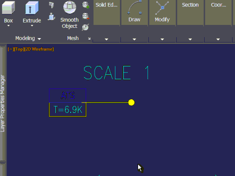

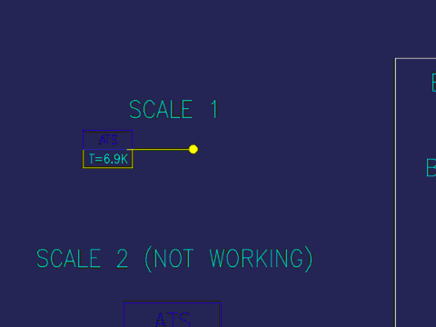

I have a block that I would like to use for different scales. See attached.
I have a simple box with text attributes and a leader that has a solid circle in lieu of arrow, however when I change my dynamic block from the small scale to the bigger scale the solid circle will not follow through. See attached file.

The Circle and the Hatch are not included in the Scale Action. After adding them to the Scale Action Selection Set, the block seemed to work properly.
oops.... I missed the note in the lower left of the drawing. Instead of adding the circle and Hatch to the Scale Action, apply a Coincident constraint between the endpoint of the line and the center of the circle.
like this?
a simple Coincident on the end point and the circle seems to have solved it.
SW TAG2.dwg
