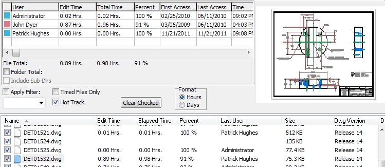

Patrick Hughes Posted February 15, 2015 Posted February 15, 2015 It would be difficult to see what time has been spent in the past. Â Â AutoCAD's TIME command is for the most part useless as it is cumbersome to have to turn it on and off as you work. Not only that but often when you start a drawing from another drawing previously accumulated time is assigned and must be reset. Â Â For those reasons and more I've devoted much effort in creating a time logging program specifically for CAD and other engineering related work called CadTempo. This is only one type of captured time view you will see. Â Â It is not free but you can download a fully functioning 30 day trial from my web site in my signature. Works with all versions of AutoCAD (and LT) from R14 to 2015 Quote

Patrick Hughes Posted February 15, 2015 Posted February 15, 2015 Well if you wanted to get specific Dana, you can by creating task lists. Â Â There are a plethora of reports that can be generated. I was recently reviewing drawings I did 5 years ago and the time from that period was still maintained. Â Â I hope you find it worthy of continued use Dana. If it doesn't meet your needs I'm willing to entertain their inclusion. Quote

Patrick Hughes Posted February 15, 2015 Posted February 15, 2015 No doubt that BIGAL's .lsp will tell you what your CAD operator is (or in this case isn't) doing to rack up the time on his/her drawings. Â Â BIGAL, if you found it to be somewhat burdensome for 8 guys take a look at CadTempo. All users are easily viewed and excel spreadsheet reports can be made within the viewer with just a few button clicks. Quote
