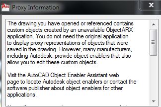

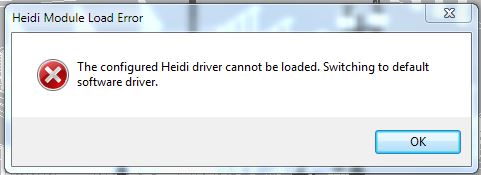

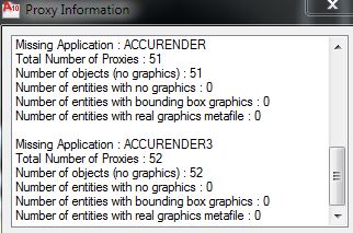

I been using autocad since 2000 so then I have this weird situation with a heidi driver and a proxy situation, thers a way to fix this...

Re: Proxy. Hint: Visit the AutoCAD Object Enabler Assistant website page. Apparently you have some objects in your drawing brought over from an AutoCAD vertical product.
Re: Heidi driver. Could be a conflict between Windows and your video card driver. Try this...
  1. In Options, select the System tab.
  2. Click on the Performance Settings button.
  3. Turn off Adaptive Degradation. (because you are there)
  4. Click the Manual Tune button.
  5. Un-check Enable Hardware Acceleration. (required)
Test. What happens?
For the Heidi driver problem I turned off screen saver and lock screen.
Read this...http://www.cadtutor.net/forum/showthread.php?33642-Configured-Heidi-driver-cannot-be-loaded

Object Enablers, looks like you need something for Accurender, in which case Autodesk will not have anything to help with that, you'll need to check on Accurender site.
