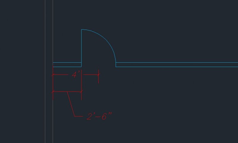

Sengna Posted February 13, 2015 Posted February 13, 2015 Which method is the correct way to dimension the location of the door for the floor plan top of the bottom one (on pic below)? i am not sure if i should reference from the wall to the center of door or the the door jam? Do you guys have the standard dimension reference sheet that i can have, could you please share with me thanks. Quote
ReMark Posted February 13, 2015 Posted February 13, 2015 If you dimension to the center the door size (width) could change but the dimension would stay the same. Quote
eldon Posted February 13, 2015 Posted February 13, 2015 Or the dimension to the door jamb could be the over-riding factor. Take your pick Quote
Sengna Posted February 13, 2015 Author Posted February 13, 2015 I kind of lean towards dimension from the wall to the door jam and maybe call out the door size, but not sure what others do. Quote
Dana W Posted February 13, 2015 Posted February 13, 2015 (edited) First thing, there should be a door schedule showing nominal size w & h, for example 3068, (3'-0" wide, by 6'-8" high), and the rough opening dimension for each. The manufacturer's website should have sizing charts. The rough opening needs to accommodate the nominal size of the door, plus the jamb/header thickness, plus a minimum of 3/8" shim space at the jambs and header. The door schedule should also include (we're talking pre-hung doors, right?) the manufacturer's nomenclature including quantity by size subdivided into quantity of swing direction. There probably should also be a sub catagory for door type, interior slab, patio, entry, etc. Then, when you get to the plan view, a lot of the doors will fall exactly in the center of a given space, like a hallway or closet, or they will be at a set minimum distance out of a room corner. This minimum distance has to allow for whatever the door casing width is. There is really no need to dimension these doors at all. Now when a door does not fit these criteria, you can either dimension to the center of the door, or to its NOMINAL width, and leave it up to the Framing carpenter to read the door schedule. That is his/her job. Each door and window needs to be called out whether they need to be dimensioned or not. Put a 3068 or whatever the nominal size is right by it, and the door type too. EDIT: I meant Framing carpenters, they are the ones that make the holes for the doors. Edited February 14, 2015 by Dana W Quote
ReMark Posted February 13, 2015 Posted February 13, 2015 I would never leave it up to some guy in the field to determine where a door should fall. Give a dimension of some sort (jamb or center I don't care) and end any doubt. Quote

ReMark Posted February 14, 2015 Posted February 14, 2015 Rough opening dimensions belong in a schedule just like that for windows is what I was taught. Both manual and CAD architectural drafting and design classes I took had us dimension the centerline of the door opening. Quote
Dana W Posted February 14, 2015 Posted February 14, 2015 Rough opening dimensions belong in a schedule just like that for windows is what I was taught. Both manual and CAD architectural drafting and design classes I took had us dimension the centerline of the door opening. Exactly the way its done. Quote

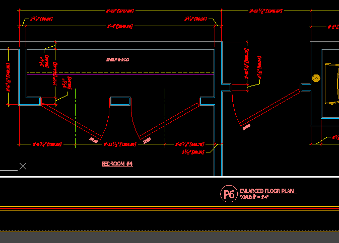

Dana W Posted February 15, 2015 Posted February 15, 2015 Here's an example. As to the single door on the right, the entry into the office. It is automatically assumed that the door will be centered if there are no dimensions. It is standard practice among ticky tacky suburban sprawl builders, and it is what my current client is used to seeing. He will be the G.C. on this, his own house, and will probably be doing a good deal of the construction, or at least yelling at people that are building it. What's not standard are the alternate units. This house will be bid on by materials vendors here in Florida, and will be built in Southeastern Panama. Quote
