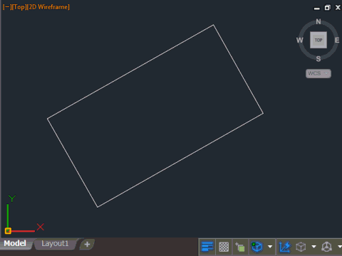

donaldo Posted February 18, 2015 Posted February 18, 2015 I see most Architectural and Engineering Site Plan Drawings are left in their Grid orientation, normally to North in Model space but have them squared up to the paper when in Layout Mode for ease of Reading etc. I undertake some surveys and upload them to autocad and tend to rotate them off grid in model space so they are viewed square in Layout mode. How do I do this the professional way, ie leave the orientation, as is, in model space and have it squared up in Layout. Thank you. Quote
ReMark Posted February 18, 2015 Posted February 18, 2015 Have you tried rotating the viewport? http://docs.autodesk.com/ACD/2010/ENU/AutoCAD%202010%20User%20Documentation/index.html?url=WS1a9193826455f5ffa23ce210c4a30acaf-74a2.htm,topicNumber=d0e35964 Quote
eldon Posted February 18, 2015 Posted February 18, 2015 I tend to leave surveys in their true geographic alignment, so that the architect knows where North is. Also most of the annotation and levels are also East - West. By rotating the whole survey, I would have thought that it would make it LESS easy to read. If you need to rotate it in the Layout, try the UCS method. When in the Layout in model space, set up a UCS based on one side of the building. Then go to Views - 3D views - Plan View - Current UCS, and it will be as you require. Quote

nestly Posted February 18, 2015 Posted February 18, 2015 I also agree with eldon, rotate the UCS, PLAN > Current, and then name the custom UCS for future reference. Quote
BIGAL Posted February 19, 2015 Posted February 19, 2015 Word of warning we use UCS OB most time give it a name etc so can retrieve if you pick a 3d line or two 3d points your UCS will be on an incline plane which can give weird measurements so make sure you pick a line with no z's . We make a temp line and zero it. If you need to paste from another dwg to true co-ords just do UCS W paste then UCS R myucsname no need to do the plan bit twice. Quote
