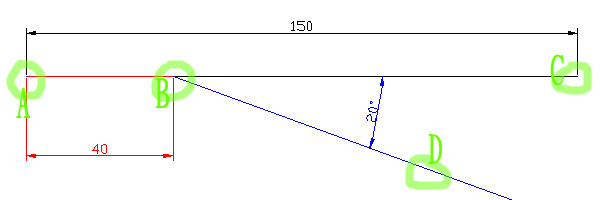

I have question, is it problem? I want to draw a line, A to C. 150, and draw that 20 degree, from point B but AB is it duplicate line (construction lines.? because AC is I need. AB must erase? in this case, any idea please!
or FROM OSnap

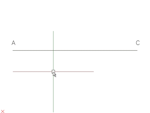

Instead of drawing line AB, just hover over A until the Tracking Point marker appears. Drag the mouse to the Right and type 40
Alternately, start the LINE command, type FROM at the command line, Click endpoint A, then specify to where to begin the line "from" point A (ie 40,0)
