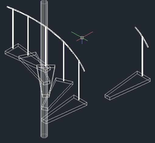

As you can see from my drawing, i have an arched staircase, I want to know how can i extrude it in a way that it also descends or arranged like the staircase and do not look like a solid wall. Salme Extruded_recover.dwg
Thanks for those who will help :)

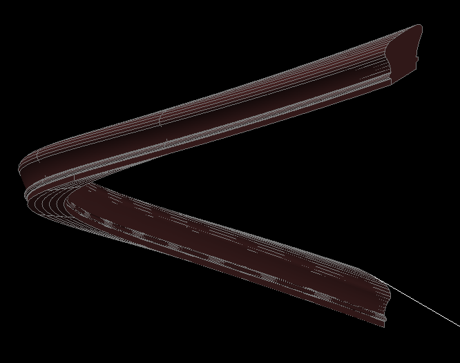

An example of a curved handrail using a simple profile.
The profile was extruded along a path formed by part of a helix. The difference in height between the top of the rail (at low end) and the top of the rail (at the high end) is 96 inches. The helix base radius was 72 inches; top radius was 72 inches. The number of turns was 0.25 so basically the railing turns 90 degrees.

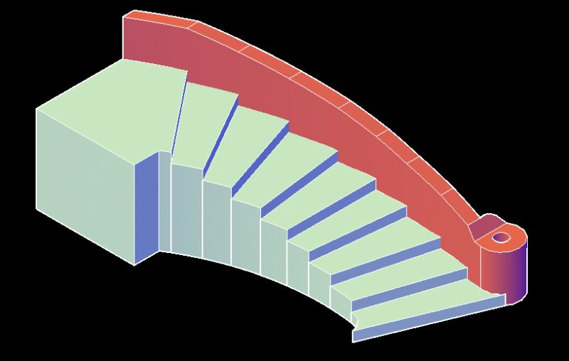

Is this sort of what you had in mind? I extruded your "railing" then sliced it using a surface I constructed out of a 3Dpolyline. Given the height of your steps (a quarter of an inch) I had to guess at the height of the rail off the top of each step. I used a height of one inch. Looks almost like a parapet wall on a highway overpass don't you think?:lol:
A simple way to create a 3d spiral stair is to make a single tread block and copy vertically and rotate the correct angle, the handrail can be a simple circle extruded along a path the only tricky bit is you must set up a ucs with center pt as the stair and incline angle equal to the rise then just extrude along path.
BIGAL: Did you open the OP's drawing and take a look at his stairs? Your suggestion is good but won't necessarily work in the OP's drawing unless he changes his floor plan.
Remark I didn't and went back to have a look just read spiral stairs as you provided can be done by extruding shapes at correct Elevation so stairs would float.
