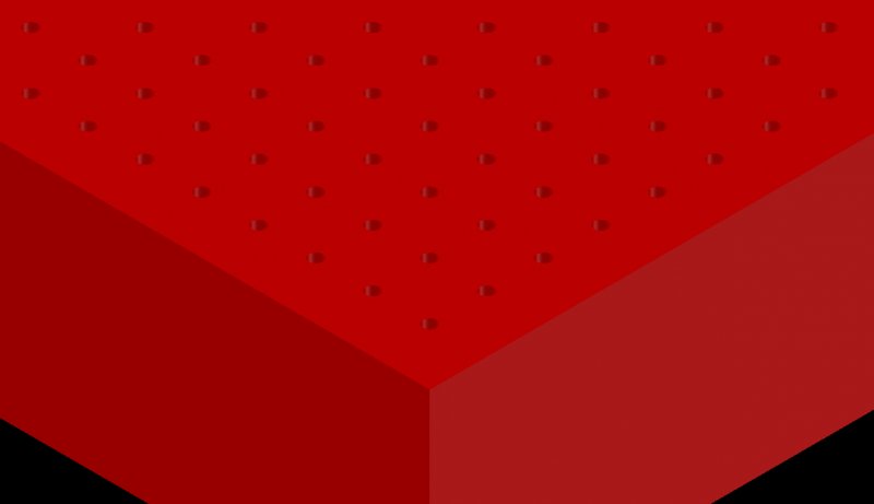

I downloaded your sample drawing from Dropbox and I see that you already subtract some of the cylinders from the rectangular 3D solid.
On my first attempt this is the result I got.
The maximum number of history nodes in a solid would be exceeded.
You may want to convert the solid to a brep.
At least two solids, surfaces, or coplanar regions must be selected.
My second attempt was successful as far as it went. This is what I did.
I sliced your model in half along the front to back axis. I retained only the right side. I ran the BREP command after which I subtracted the cylinders from the rectangular solid. It took a while to see any results but when it finally completed I now had holes where the cylinders once were. At this point I mirrored the object and unioned the two halves together. Mission accomplished.
Any questions?
A view of a small section of the lower right hand corner. The holes go all the way through.
