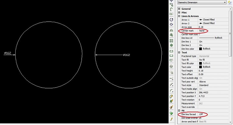

camril Posted December 16, 2008 Posted December 16, 2008 Well I'm interested - can I break or trim diameter arrow like in picture? Circle diameter is 162. But as I see diameter arrow is partly removed. How can I do so? Quote
soleary Posted December 16, 2008 Posted December 16, 2008 Well I'm interested - can I break or trim diameter arrow like in picture? Circle diameter is 162. But as I see diameter arrow is partly removed. How can I do so? You can't trim a dimension. You're using 2002 right? You can do what you're looking for but it's a workaround. Start the qleader command and press enter for settings. In the Leader line and Arrow tab, reduce the number of points to 2 maximum. In the Attachment tab choose 'Underline bottom line'. Click ok. Pick the left quadrant as the start point. Make sure ortho is on and pick the second point just beyond the centre of the circle. Press enter for text width. Enter %%c162 for your text. You will need to move the text afterwards. Note this 'workaround' will only work for a horizontal leader as otherwise a landing will be put in. Quote
Raggi_Thor Posted December 16, 2008 Posted December 16, 2008 This is Bricscad, but I think you have the same settings available in AutoCAD. I can move the text close to the center, but the arrow will flip to the other side if I pass the center. Does that make sense? Quote

totzky Posted December 16, 2008 Posted December 16, 2008 Originally posted by Raggi_ThorThis is Bricscad, but I think you have the same settings available in AutoCAD. Yes, It can be done in Autocad... with DIMTOFL set to zero. Quote

totzky Posted December 18, 2008 Posted December 18, 2008 Originally posted by SolearyBy the way, I think DIMASSOC was introduced in 2002 (OP's version) and it set to 2 by default - so I don't believe that has an effect what was asked. Forgive me for my ignorance, I was not aware of that. Originally posted by SolearyIf you can reproduce it using the settings in the dimension style dialogue box, please let us know. The nearest I can come up to is a radius dimension with dimatfit set to 2 and dimdle set to >0. Quote
dbroada Posted December 18, 2008 Posted December 18, 2008 my package matches the posted image exactly - without any changes. Quote
soleary Posted December 18, 2008 Posted December 18, 2008 my package matches the posted image exactly - without any changes. Hi Dave. I'm using 2008 and can't reproduce it just by creating a specific dimension style. Are you saying that you can? If so, how is it done? Quote
dbroada Posted December 18, 2008 Posted December 18, 2008 Hi Dave. I'm using 2008 and can't reproduce it just by creating a specific dimension style. Are you saying that you can? If so, how is it done?therein lies the problem. I have no idea. I just selected the diameter command from the menu (one of the few things I do from menus) and there it was. I can't get any other style! I'll have a play to see what I can change but I am actually busy right now. Quote
dbroada Posted December 18, 2008 Posted December 18, 2008 I thought I had found it. I have "best fit" selected and was only drawing small circles. I change from "best fit" and got a full diameter arrow line. However I have now drawn a large circle and "best fit" is locked so I can't get back to how I would normally chose. Quote
