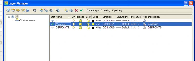

Schumi Posted February 24, 2015 Posted February 24, 2015 In the layer manager, trying to set the default linetype for a layer. Clicking on the linetype opens the select linetype dialog. I can pick another linetype but the setting for the layer doesn't change/hold. This is in Land Desktop 2006. Seems like this problem would've come up somewhere but I can't find anything on it. Any ideas? Thanks. Quote

Schumi Posted February 24, 2015 Author Posted February 24, 2015 When the Select Linetype dialog closes, the new chosen linetype never appears in the layer manager. It happens with any linetype, in all drawings. I've been digging deeper & the change can be made to the drawing on another computer (running AutoCAD 2015). I actually found out I have another LDD2006 workstation here that also won't hold linetype changes. I repaired the AutoCAD install on the first workstation. The linetype setting worked on the first drawing I opened, then when I opened the "suspect" drawing, the linetype setting wouldn't hold again. Seems as though something in this drawing file (& possibly others?) is causing this to happen in LDD2006? I've attached a stripped down version of the "suspect" drawing. Thanks. Test.dwg Quote

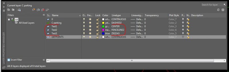

ReMark Posted February 24, 2015 Posted February 24, 2015 No problem here changing the linetype. I like how someone overrode the layer color. Not a recommended practice. I also created a new layer with a different linetype (and color) without any problem. I was able to create three new layers and get the linetypes I assigned to each to "hold". What programs are you using on these drawings? I ran the -purge command and it found/deleted 1159 Regapps! Jeez, what is that all about? I think 25 Regapps is too many. LoL Quote

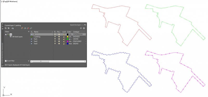

ReMark Posted February 24, 2015 Posted February 24, 2015 Audit found and fixed 327 errors. Saved and closed the drawing. Opened it back up and all the layers were still listed. Created two more objects on layers Test2 and Test3. All layers displayed their assigned linetypes. Quote

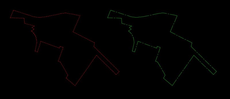

eldon Posted February 24, 2015 Posted February 24, 2015 Even only with using LDD 2005, I managed to change the linetype Quote
