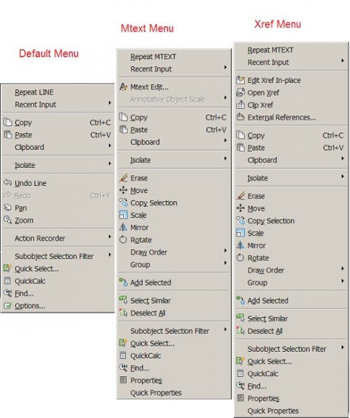

Well my whole right click menu got messed up. The clipboard is gone and the only thing I can do when I click an x-ref is open up the x-ref manager instead of being able to open it or edit it in-place. All my right click settings are fine. I think something got screwed up in the CUI. I just don't know how to re-add them or restore it without a complete re-install.

From your description, it's still difficult to tell whether contextual right click menus are working or not for other object types. Perhaps you could post a few screenshot showing the default Right click menu, the right click menu for MTEXT, and finally the right click menu for Xref
