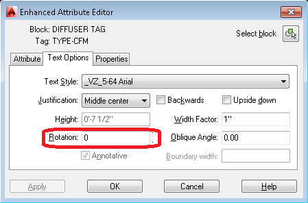

Rotation, along with other settings can be assigned to individual attributes in the Enhanced Attribute Editor. Double click the block to access it.

I'm starting to see the picture now that I opened your block. I misunderstood before. What got me is when you said it was different annotations in the same block. What you really mean is the different displays of the annotation scales for the same piece of text. I'm not sure that's going to be possible.
