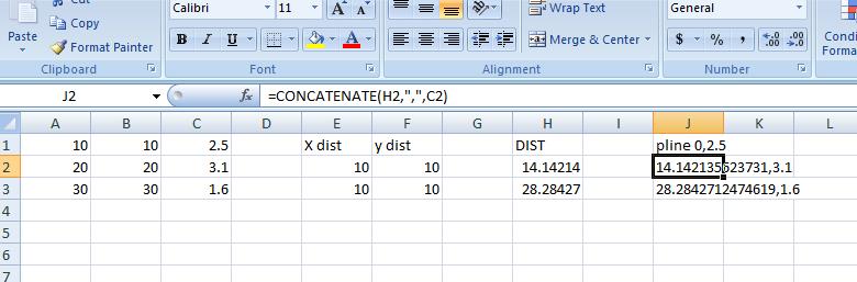

You dont need a lisp just use excel and use the concatenate function to make a new column just copy the column to Autocad command line. The graph of the points will appear.
In excel take each X,Y and compare to next line and work out ground distance (X*X+Y*Y)^0.5 this becomes the X co-ord and the Z now becomes the Y for a pline command.
