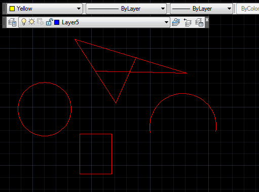

hi, can someone let me know of a routine which moves selected objects (on separate layers) into another layer (say layer 0 ) but the objects need to keep the same colours of the original layers (byblock)
I am trying to reduce the number of layers in a drawing by pushing them all into a separate layer, but they all become bylayer taking on the new layer colour and i cannot distinguish the various elements ...

thanks for your help Tharwat....
the entities can move to layer 0, but the entity colours become the colour of the layer 0 (bylayer)
i was looking at the entities to come into layer 0, with different colours - (which were the colours as seen in the original layers)
i.e. if the entities were red bylayer in layer 1, and green bylayer in layer 2,
when they come into layer 0, they still come in as red and green....
it keeps the drawing looking interesting
thanks.
It should not change the color of entities and it moves entities to layer 0 only .

i am attaching a messy drawing with a bunch of layers ... all with its own bylayer colour objects.
I would like the objects in these various layers be moved to layer 0, but to maintain the same old colours (byblock) which they had in their previous layers. and remove the older various layers.
it will make the drawing look more interesting than all objects having one flat single colour of layer 0
thanks
(have tried to insert a drawing ... hope its been attached)
i.e. the red coloured objects remain red in layer 0, the green/blue /yellow etc objects come in as green/blue/yellow objects in layer 0 etc.....
If I've understood correctly, please try the following:

I think you want to move objects to a specific layer and re-color each object according to its original color in its original layer .
Your first post does not give any hint about this goal . but anyway Lee step over and gave you the one before I read your attached drawing .
Sorry for not being too clear in my post... yes this was exactly what i needed... and Lee's program works !!!! :D
