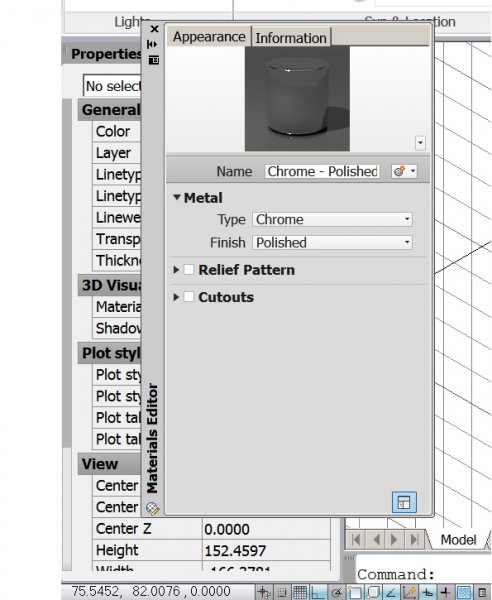

turboCAD Posted March 10, 2015 Author Posted March 10, 2015 Reflectivity but it seems like I don't have it: I have seen in a post on another forum that on the "materials editor" Reflectivity and other options should have appeared but they don't. Why? Thank you, ReMark, I think reflectivity would do the trick but I cannot find it. I did apply Chrome Polished. EDIT: Chrome Polished doesn't have Reflectivity adjustment; it is a predefined material Other materials have those options, for example Chrome Satin 1. Ok, now back to working on reflectivity. I also am using 3 light sources set to 7500K Quote

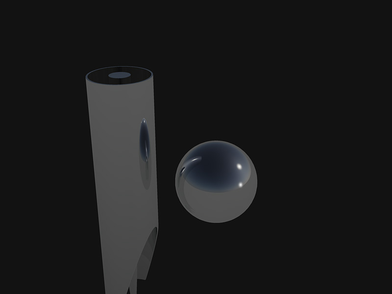

Cad64 Posted March 10, 2015 Posted March 10, 2015 Materials like this which are metallic or highly reflective are dependent upon their environment and surrounding elements. Switch your Background to Sun and Sky and render again. I placed a sphere next to your object and applied the same Chrome material. Then I switched to the sun and sky background. See the difference? Quote
ReMark Posted March 10, 2015 Posted March 10, 2015 turboCAD: If anything I said helped you it was purely accidental. Listen to a real expert like Cad64. Unlike me he knows what he is doing. Quote
Cad64 Posted March 10, 2015 Posted March 10, 2015 Thanks ReMark. You were on the right track though, about the environment and background and everything. Reflective materials need something to reflect. If you just have a single object floating in an empty blank white atmosphere the material has nothing to work with so it just appears flat. Quote
