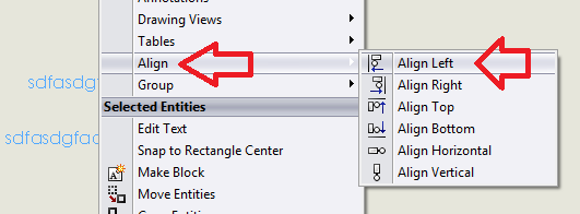

Greetings,
I'm in my first week of SW, so I may have overlooked an easy explanation. I'm trying to line up lines of text in my drawing notes. The characters in new lines of text don't exactly line up with the one above. Scooting things around with the spacebar, text will be off by half a space, or some amount depending on the letter. The tab key doesn't use the same spacings from line to line, and sometimes won't work at all when parked in front of a character.
Is this a possibly a bug in 2013? Is there a way to set up custom tabs or force my text to align somehow?
Thanks
When you can't find something in SolidWorks - it is almost always on the Right Mouse Button menu.
