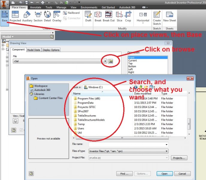

As MarkFlayler says, you can, here are just some graphics to complement
