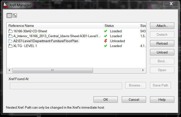

I've attached the screenshot of the xref Manager for this drawing.

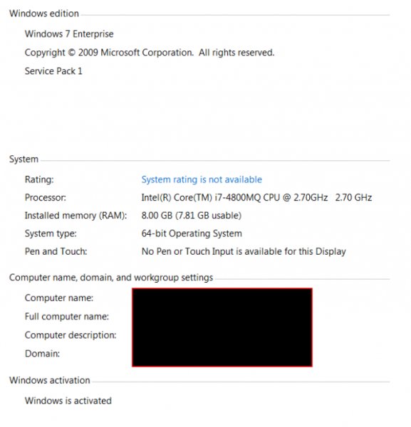

BTW, what are your system specs?
Are you working off of a network or on a standalone workstation?
So it turns out that the system was crashing because my RAM was not allocated properly. I got IT to fix that for me, but it's still slow when I try and work with the xref file. But to answer your question, I have included a screenshot of my specs.Capture.jpg
The drawings are on a network. I would like to somehow create a local file that I can work from so that I can update the project folder on the network with my new drawing.

Yes, well one of the reasons I posted the screenshot in the original post was to show that the Detach option was not available for all the files (it is shown grayed out). So I'm not sure how to work around that. I saw this same suggestion on another help site, but somehow it doesn't apply to my situation (?) Story of my life, actually.

Okay, so I think it was a bunch of nested xrefs. I narrowed down which drawing it was and am just working with that drawing alone since it has all the information I need anyway. This isn't really a solution to the originally stated problem and, just for the benefit of others who may be using this thread for help with a similar problem, I may return to this file when I don't have a deadline to see if all of your suggestions would fix the issue. Thank you all for your help.
