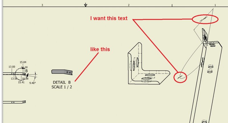

How can I change this orientation, the dimenson text is aligned with the angle axis which is logic, but on a dwg a would like to see this text front view, is it possible?
I suggest creating a view perpendicular to the plane of those dimensions.
Yes, the thing is that the bending on heel is not the same as on the face, as you can see on first pic, there is a view as you sugest but the value is 9.46° on face, and 13.26° on heel that is why this data is important for me.
