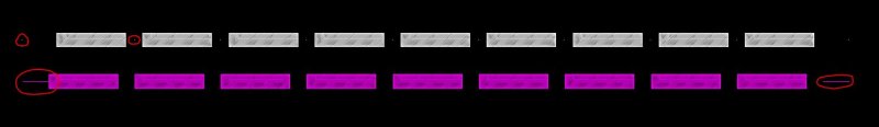

kbgooner Posted March 17, 2015 Author Posted March 17, 2015 Hmm... still not getting it. My shape file does not work, i used a 6 metre line with a global width of 100mm but when i use the shape comand to insert it, i just get a line with no width. Quote
ReMark Posted March 17, 2015 Posted March 17, 2015 Yeah, that's because the width of the polyline is not recognized by the MKSHAPE command. There's a work-around but the results I got in a quick test are not entirely satisfactory. I may have to experiment more. Quote
ReMark Posted March 17, 2015 Posted March 17, 2015 My first two attempts yielded the following results. I've circled, in red, what I consider to be the unsatisfactory portions of each linetype. I'm pretty sure the problem can be solved but I'll need another eight cups of coffee before my mind is even semi-functional. Created using MKSHAPE and MKLTYPE commands. Quote
