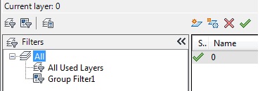

vernonlee Posted March 20, 2015 Author Posted March 20, 2015 Have you tried this? Hi RobDraw, i would if i have the save button. Any setting to bring it out? This is mine I am using Autodesk Autocad 2014 Quote

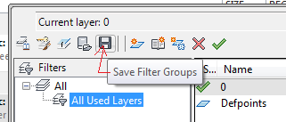

RobDraw Posted March 20, 2015 Posted March 20, 2015 How about that? It's only available in verticals. See this thread, http://forums.autodesk.com/t5/autocad-2013-2014-2015/can-t-save-import-layer-filters-in-acad-2015/td-p/5517022, and check out the links for a workaround. BTW, your profile ways you are using 2015 not that would have made any difference in this case. Quote

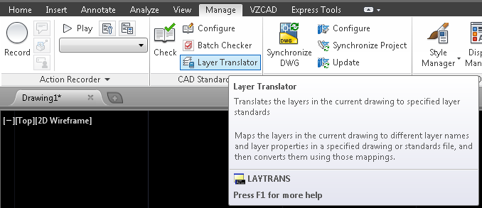

RobDraw Posted March 20, 2015 Posted March 20, 2015 Layer states need to be exported to a .las in order to import. You might want to look at Layer Translator for a more powerful tool. Quote

vernonlee Posted March 21, 2015 Author Posted March 21, 2015 Layer states need to be exported to a .las in order to import. You might want to look at Layer Translator for a more powerful tool. I have exported/imported layer states beween drawings before. just not sure how it can be useful in my situition. Perhaps you can elobrate? Layertrans i use before as well mainly to convert all layers to another layer. How would this help in this? Thanks Quote
