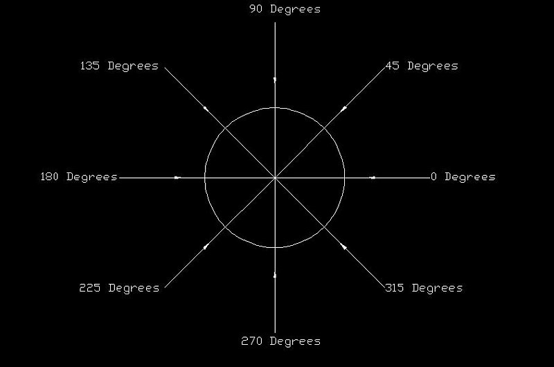

skipsophrenic Posted December 17, 2008 Posted December 17, 2008 The other thing to remember when drawing angles in AutoCAD, is a line drawn at 0 degrees would not be vertical, it would be Horizontal. And the angles rotate anti clockwise NOT clockwise - see image below Quote

Tankman Posted December 19, 2008 Posted December 19, 2008 The other thing to remember when drawing angles in AutoCAD, is a line drawnat 0 degrees would not be vertical, it would be Horizontal. And the angles rotate anti clockwise NOT clockwise - see image below [ATTACH]8935[/ATTACH] I get so many drawings that are laid out clockwise, what a turn off! Nice post skipso, can we send this via bulk mail to some engineers we all know 'n love? I often see 0° at 6 o'clock, 90° at 9 o'clock, etc. Feel like I'm workin' backwards! Quote
mugshot Posted December 19, 2008 Posted December 19, 2008 line> pick on the spot where you want it, hit Quote
skipsophrenic Posted December 19, 2008 Posted December 19, 2008 I get so many drawings that are laid out clockwise, what a turn off!Nice post skipso, can we send this via bulk mail to some engineers we all know 'n love? Feel free, it only took 2 mins to draw. I often see 0° at 6 o'clock, 90° at 9 o'clock, etc. Feel like I'm workin' backwards! Nice, very nice, i'm getting a sense of "Dé ja vué" Quote
Tankman Posted December 19, 2008 Posted December 19, 2008 Feel free, it only took 2 mins to draw. Nice, very nice, I'm getting a sense of "Dé ja vué" As a youngster, I always thought clockwise was correct. Now I know, counterclockwise is the only way! I get a little sick when I receive drawings to work with that are all backwards, makes work a bit more difficult. And to make it worse, the same professionals continue working wrong. What's with that? Quote
skipsophrenic Posted December 19, 2008 Posted December 19, 2008 That's because an angle measure goes forwards, so they go by that, so in essence you could say that the whole worlds BACWARDS! LOL Quote
