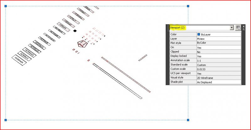

Andrew1979 Posted March 25, 2015 Posted March 25, 2015 I have found a major bug in an AutoCAD drawing to do with the viewports. All the existing viewports cause a crash when running export to dwg from paper space. Anyway, I have found that adding new viewports fixes the problem. But there are a lot of viewports, and I want to make the new viewports zoom into exactly the same objects that are in model space as that of the old viewports.....quickly. Is there a way to somehow do that? I have been clicking inside the old viewports, using the view command, saving the current view, then going to the new viewport and restoring the saved view to the new viewport......takes quite a bit of time to do. Any suggestions? THanks Quote

Dadgad Posted March 25, 2015 Posted March 25, 2015 (edited) Start the COPY command> select a basepoint, one of the corner grips seems like a good choice, enter displacement of 0,0,0 hit ENTER. At this point you should have two identical viewports, right down to the current view in them both, being the same as you originally had in the viewport which you copied. It will look like you only have one, because they are exactly on top of each other, as evidenced in the screenshot showing my Quick Properties. Presumably, the new Copy of your old viewport will be fine, and you can then ERASE the one with which you started. If you don't already use it, turn on SELECTION CYCLING, which will help you to figure out which of the viewports you are selecting for the ERASE command. Give it a try, and read the commandline prompts, it is really quite simple. Make sure you remember to LOCK your viewports. :wink: Edited March 25, 2015 by Dadgad Quote

SLW210 Posted March 25, 2015 Posted March 25, 2015 I've seen problems before where it was necessary to create a new viewport, because the original was acting strange. I would trace an outline over the viewport then CHSPACE into the model, you can then Zoom Object or Zoom Window using the Traced area of the viewport. There should be a LISP or 2 around that will place the boundaries of the viewport into Modelspace. Quote
rkent Posted March 25, 2015 Posted March 25, 2015 Make a viewport on top of the existing but slightly larger or smaller so you can keep track of them. Use VPSYNC and pick the original and then the new one, erase the old one. Use matchprop before erasing to set the layers the same in both. Quote
