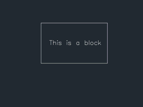

Beeftimer Posted March 25, 2015 Posted March 25, 2015 I've read many articles and threads about how to insert a basepoint, but none have answered the question I have. My question is how do I (easily) REDEFINE a block's basepoint? I know how to put in a basepoint initially, but what if I want to keep changing it subsequently? Every time I try and change it, it gives me this response: ** Base point parameter already exists in block definition. ** I have to go back and undo everything up to the point where I defined the basepoint in the first place. This is not convenient. Is there not an easy way to change a block's basepoint over and over again if I wish? I feel like there's got to be a command for this. I would think that using the Basepoint command in the block editor would suffice, but obviously it doesn't. I know I can move the block around and change the origin, but what I need is to redefine the basepoint. If you have any suggestions that work, or if you happen to know that there indeed isn't an answer, please let me know. Your feedback is appreciated. -Beef Quote

nestly Posted March 25, 2015 Posted March 25, 2015 AutoCAD has nothing built in that will allow you to change a block's basepoint without either exploding it, or entering the Block editor. LeeMac's lisp is your best option. I use an older version of it (CBIR - Change Block Insertion Retain position) but the current version works the same. 1) Start the lisp 2) pick the block 3) Pick a new basepoint ... couldn't be any easier Quote
SLW210 Posted March 25, 2015 Posted March 25, 2015 Is this in reference to a base point parameter in a dynamic block? It might help to post the block. Quote
Beeftimer Posted March 25, 2015 Author Posted March 25, 2015 AutoCAD has nothing built in that will allow you to change a block's basepoint without either exploding it, or entering the Block editor. LeeMac's lisp is your best option.I use an older version of it (CBIR - Change Block Insertion Retain position) but the current version works the same. 1) Start the lisp 2) pick the block 3) Pick a new basepoint ... couldn't be any easier [ATTACH=CONFIG]53459[/ATTACH] Yes, this will work fine. It just seems crazy to me that AutoCAD doesn't have something built in that would allow you to do the same thing. Thank you for your time, everyone. Quote
FerrousJack Posted February 1, 2016 Posted February 1, 2016 (edited) For anyone else still having this issue I thought I would reply. If, when you try to place a basepoint parameter the response is: ** Base point parameter already exists in block definition. ** then you need to delete (or move) the existing basepoint. The problem is that sometimes you can't see it. I recently had this exact same problem working with 3rd party blocks. The blocks had been defined thousands of feet off of the 0,0 point, and the defined basepoint was thousands of feet off from that in the other direction. I had to zoom WAY out to see the existing basepoint, but once I found it, I was able to delete it a redefine a new basepoint. Basically, if there is a basepoint already defined, you should be able to see it and manipulate it. If you can't, then there may be a visibility setting issue or corruption issue. Also, there is no need for a LISP solution here if everything is working normally. Just go into the block editor and manipulate the basepoint like any other object. Edited February 1, 2016 by FerrousJack forgot something! Quote
