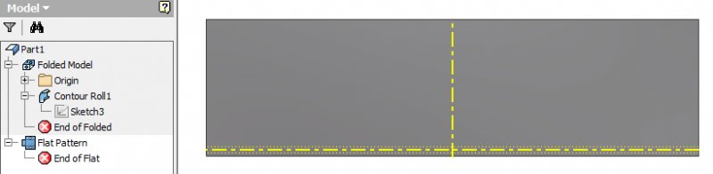

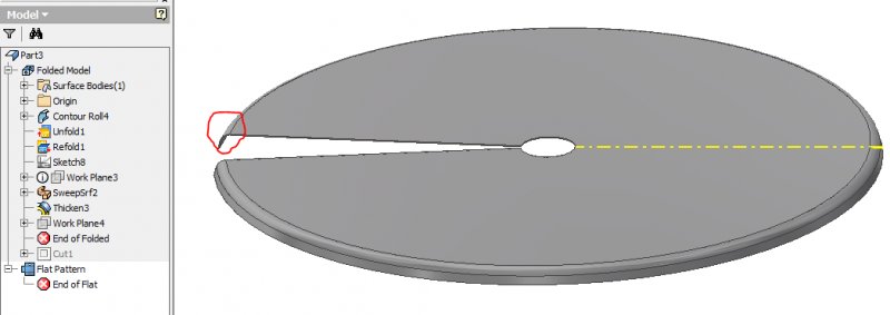

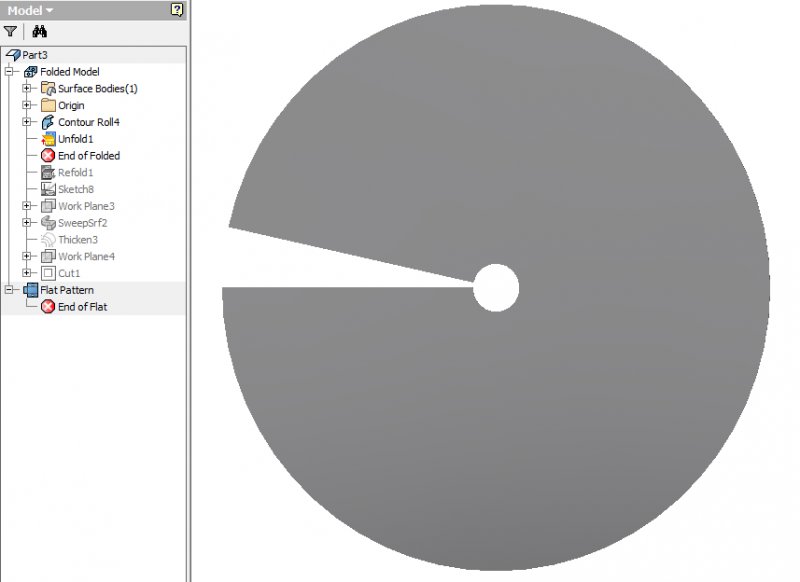

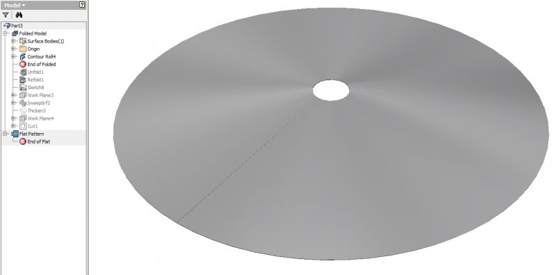

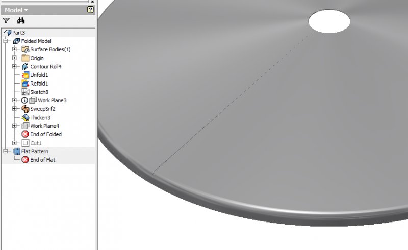

Im desperatly trying to model a cone for a hygenic vessel we have to design but im having problems giving the moddel a rolled flange.
I have modelled the cone using either contour roll or surface body. Both give me the desired flat pattern.

After designing the cone, i wanted to give the edge the desired rolled flange. I tried to model this using again either contour roll or surface body.
The problem i'm having is that when i use contour roll, the entire model unfolds incorrect (the entire model unfolds along the defined contour roll axis of the rolled flange). if i use surface body, the rolled flange isn't flattened at all in the flat pattern. I hope pics will clarify
