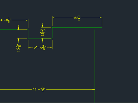

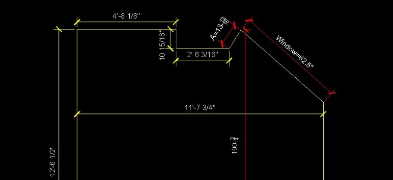

Razorcad Posted March 26, 2015 Posted March 26, 2015 Hi guys, Im wondering how can I use autocad to find the angle of 2 measurements that I have the measurements for. My Friend is going to be doing renovations in his condo, so he asked me to do an existing floor plan for him. I went to his house to take down the measurments and when I got home to draw the plan, I ran into problems drawing angled walls because I may not have taken the dimensions down proberly. Please see the attached file to see exactly what I'm talking about. There is a Column is 2'-6-3/16" by 10-15/16" right beside a wall thats on an angle measuring 13-13/16 and right beside that wall is a window measuring 62.5" wide also on on an angle. Does anyone know anytools I can use to figure out how to make these to lines connect at the right angle? (If im missing any information please ask and I'll do my best to supply it to you.) Thanks Quote

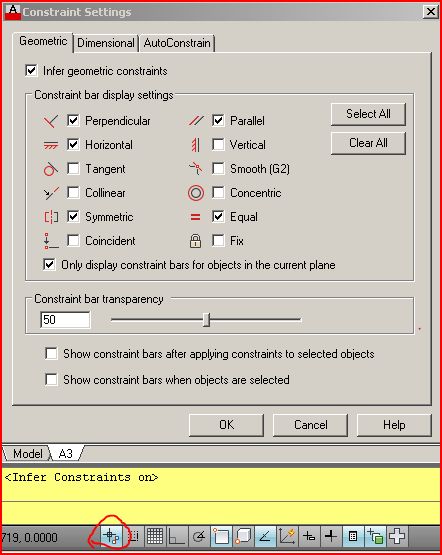

Dadgad Posted March 27, 2015 Posted March 27, 2015 You might consider using the parametric drawing capability of the software. Infered constraints might help you. I don't use it, but look at the screenshot, to get you started. I find it hard to believe that the internal corner by the long window is not a right angle. Were these measurements all taken from the same side of the walls, meaning inside or outside? Quote
Razorcad Posted March 27, 2015 Author Posted March 27, 2015 Ya i took all of the measurements from the inside and yes the window is not right angled. Theres other places in the condo thats right angled (The entrance, closet and a window in the living room.) Quote

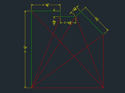

nestly Posted March 27, 2015 Posted March 27, 2015 IMO, you need some diagonal dimensions to verify that the existing construction is square/parallel if you're going to draw it within 1/16 precision. The window comes out almost 45 degrees (135degrees) which seems logical "assuming" everything else is square and measured precisely. Quote
rkent Posted March 27, 2015 Posted March 27, 2015 Ya but what about if its not a right angle??? As I said "reproduce those lengths in autocad and you have your angle." They may be 90 or they may be whatever, but with the method outlined you will have the angle, whatever that is. Quote
nestly Posted March 27, 2015 Posted March 27, 2015 Ya but what about if its not a right angle??? The key to accurate field measurement is triangulation Your screencap has the bottom of the space cut off, but assuming there's another wall below, it would be something like below. As rkent suggested, if there aren't actual corners available, create your own reference points. It doesn't matter if the walls are square or not, you'll be measuring and reproducing the actual field conditions. Quote
Razorcad Posted March 27, 2015 Author Posted March 27, 2015 Woa Nestly you hit it right on the nose because I did I test length from the corner of the window all the way perpendicularly down to a horizontal Door (Line) which was 190". Everything in this room was straight except those 2 portions of this room. Thanks for the beautiful example By the way for construction purposes should I put the precision to 1/8?? (whats ideal) Quote
