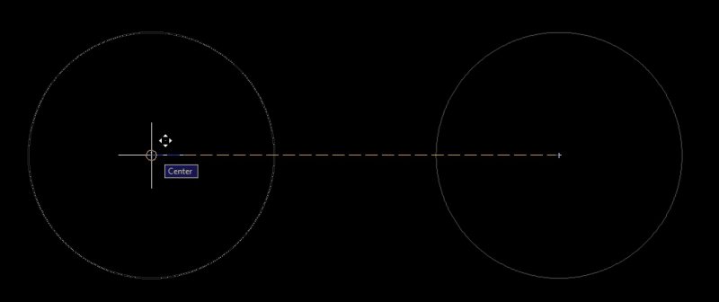

Bodwa Posted March 26, 2015 Posted March 26, 2015 I was recently upgraded to AutoCAD 2015 and it seems as though a "tool" from previous versions has either been removed or I can not find out how to turn it on. Before I was upgraded, I could have two identical objects (lets say circles with a 1" diameter), I could move one circle on top of the other and if I don't click to place the selected circle, both would essentially dissapear or ghost. Once I clicked to place the object it would appear as normal with one circle directly on top of the other. If the two objects are not identical, then they would not ghost. I use this "tool"to overlay parts that have sometimes hundreds of features, in order to find out what is different between the two. Does anyone know what I am rambling about or need me to explain a bit more? I would greatly appreciate it if anyone knows how to re-enable this "tool". Quote

Bodwa Posted March 30, 2015 Author Posted March 30, 2015 Thank you both for your replies. I had actually previously turned off selection preview when I did my original customization to get AutoCAD back to what I think is normal lol. I did try turning it on again to see if it made a difference though, to no affect. Selectioneffect removed the annoying highlight when an object was selected. One of my coworkers stumbled on the answer and it is turning off the hardware acceleration under the "System" tab and then graphics performance Quote

Bodwa Posted March 30, 2015 Author Posted March 30, 2015 I just updated my drivers using the link you attached and turned hardware acceleration back on. Turning it back on removed the function that I am trying to achieve. The top image is with hardware acceleration turned off and the bottom image is with hardware acceleration turned on. Oh and I have 16 gigs of RAM Quote

SLW210 Posted March 30, 2015 Posted March 30, 2015 I get similar to your bottom image Hardware acceleration on or off. Not sure what you are looking for. Quote
Dadgad Posted March 31, 2015 Posted March 31, 2015 (edited) Sure. There isn't anything special about the drawing, just a couple 1" diameter circles. But here it is.[ATTACH]53529[/ATTACH] Where is the OBJECT OVERLAP? There are only 2 identical coplanar circles, not sure what you mean by overlap. Might you want to turn on F12, for dynamic input? Scratching my head, trying to help. I expected there to be at least 3 circles in the drawing, with one immediately behind the other. Having reread your earlier post, I now understand that you likely intended it to be as previously described. I tried copying and moving them atop one another to understand the ghosting of which you spoke, but I still don't get it. Might you be talking about the way the continuous linetype displays differently, indicating the presence of another line below it, while still mid command? Might it be a DISPLAY issue, controlled by VIEWRES? Edited March 31, 2015 by Dadgad Quote
