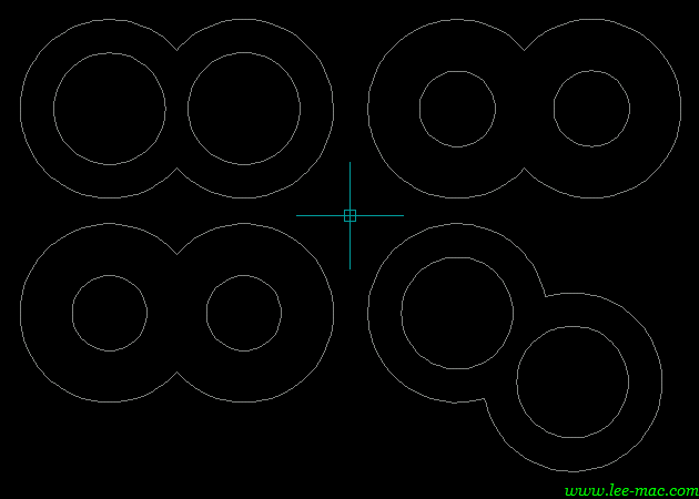

So what I'm looking for is a lisp to help with drawing some lines.. (the easy part to explain, now the awkward bit), however I want to select an endpoint and have it automatically draw 2 lines perpendicular from the startpoint to the nearest other line
(hope that makes some sense? I've rewritten it 3 times..
I tried making my own lisp but failed miserably (I've never written my own before, only tweaked others to suit my needs)
Could anyone help? I would really appreciate it..
This is an example of what I'm trying to do
Click an endpoint (highlighted by the red circle) and draw 2 lines (shown green) from the endpoint to the nearest line perpendicular from the startpoint

OK, assuming you will eventually have access to VL, the following code should allow you to simply window over all of your circles/arcs (any size / any angle) and will construct the necessary lines as per your example drawing:

Here's a quick demo:

I used the Lisp that you created at work today, oh my gosh it worked like a dream... I actually Completed all of my drawing with 2 hours to spare, that's how much I needed this.
