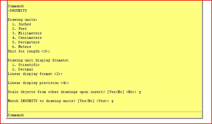

This is a preview of what to expect when you run the -DWGUNITS command.
You still need to read the command prompts carefully and slowly.
The default Metric unit is mms, which is what I use in my detailing work,
as you are working in Architecture, you MAY prefer to select Meters as your
unit of measure, maybe not. You should choose whichever is deemed the
industry standard wherever you are working.
Measurements such as AREA and LENGTH will be reported in whichever units
you specify at this point, so think about it.
Do you want area measurements to report in SQUARE METERS or SQUARE MILLIMETERS?
Go with whichever unit is prefered by the architectural community in your area.
Do you want to enter 1,000 for a line of length one meter, or just enter 1,
meaning your drawing units can be whichever works best for you?
