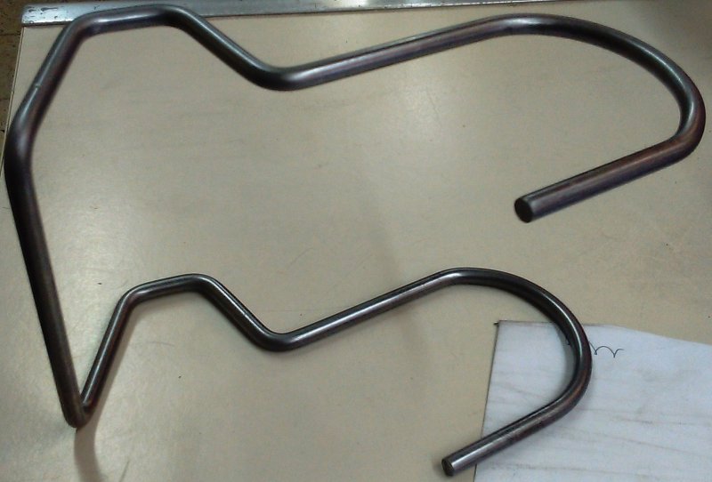

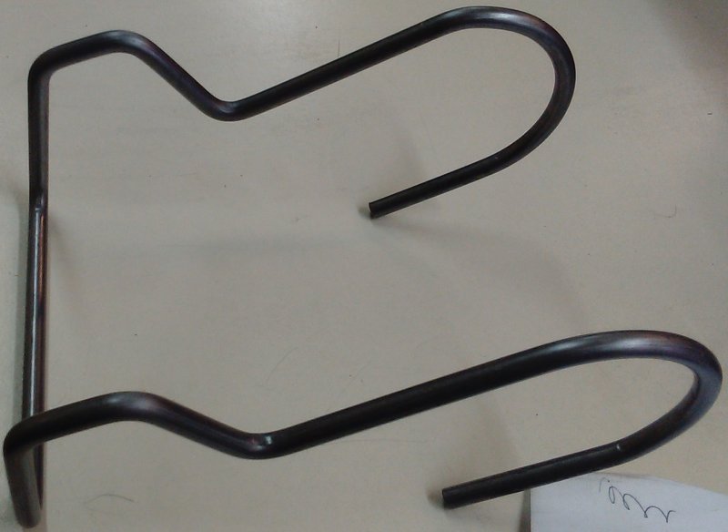

Here is same examples. can you show how to do it?

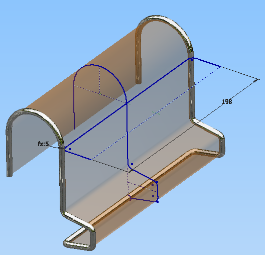

Here's one I did years ago, back when I knew nothing, as opposed to now, where I've forgot everything.
RACK, WIRE.ipt
Wire Loop.ipt

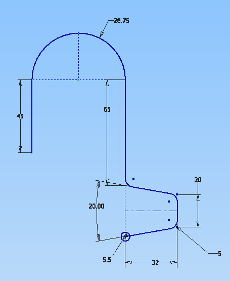

All you need is 2 2D views to create a 3D sweep path.
Frequently I use these 2 2D sketches to create a 3D sketch intersection similar to the link given above, but in this case the path is even easier.
Simply Extrude a surface body and then trim the surface for the two remaining bends.
Sweep along the edge of the surface and then turn off the Visibility of the surface body.
Any changes to the sketch or extrusion dimensions will automatically update the part.
Drag the red End of Part marker up the feature tree to just under Sketch1.
Examine
Exit sketch. Right click on Sketch1 and turn off Dimension Visibility.
Continue down the tree.
Finally, hide the surface body.
That looks like torture! Get lazy!
