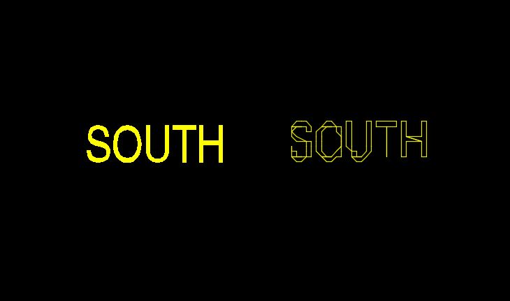

dumfatnhappy Posted April 1, 2015 Posted April 1, 2015 I'm trying to imprint on say 4 sides of a cube, anyway my problem is exploding text so I can extrude and thus imprint... I'm using express tools explode text command and it really butchers the text as shown. is there a better way to do this? or do we know what causes this? Quote

rkmcswain Posted April 3, 2015 Posted April 3, 2015 TXTEXP is just doing a WMFOUT and WMFIN. If I'm not mistaken WMFOUT results depend on the zoom level in the viewport when you run the command. Zoom in on the text as close as possible before running the command. I see a big difference when I try it. Compare the top result to the bottom result. Quote
