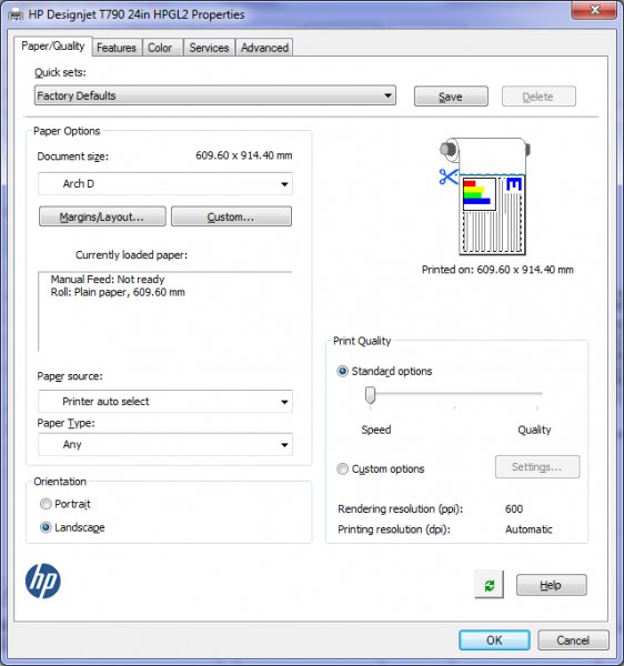

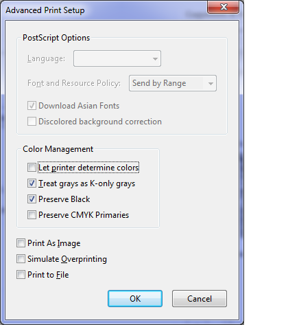

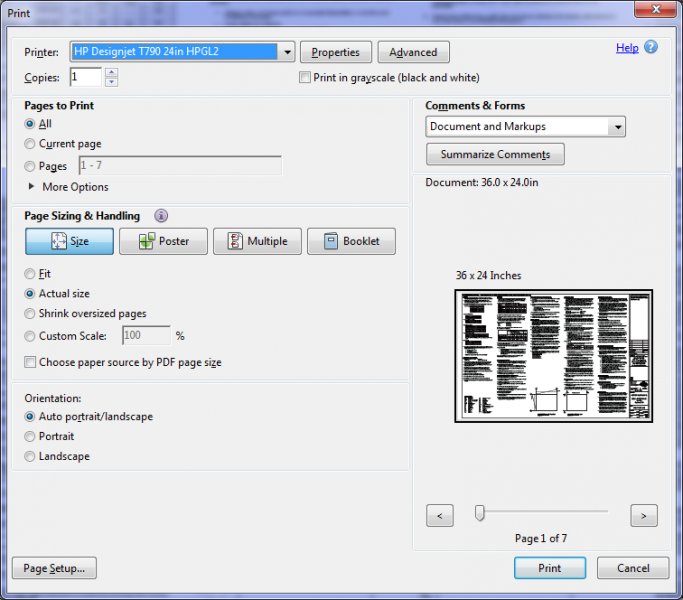

Can you post screen shots of your plot settings in Adobe Reader? Pretty sure you just have a setting off somewhere. If the plot previews look the same, I would say it isn't DWG to PDF.pc3.
I can click "Print as Image" and it works okay.... except if the file is a couple sheets or more the printer times out and doesn't work. I can "Print as Image" to 11x17. But I'm sure the problem is with the creation of the PDF. Because if I send the PDF to a client, I have to be confident that they can print it on their end without adjusting the standard print settings, of whatever PDF viewer they use.
I know this might sound crazy, but I think it's because of some other setting I have in my Acad, totally unrelated to printing.... like because I have a Layer Tool Palette on the left side:?
I'm going to try to reinstall LT stock, no modifications and see if anything changes.
