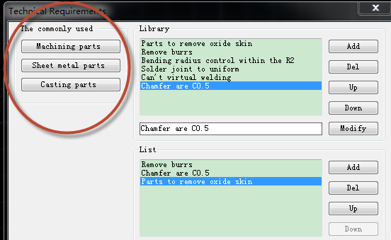

AIberto Posted April 5, 2015 Posted April 5, 2015 (edited) Dear Lisp Master Happy Easter a Text Library routine , Every time ,I need add some text to list from Text Library. Then write them into the drawing .Spent a lot of time . I thought for a long time . I hope add text to list quickly. So, I thought of using shortcut buttons. I modified the Dcl file , But I can't write lisp program. I only know basic,eg. "Command ", Dear lisp Master ,Can you help me ? I'm truly grateful for your help. Lisp and DCL file in Attach. Here is the tcf.INI file , (ini file is the Text Library) Parts to remove oxide skin Remove burrs Bending radius control within the R2 Solder joint to uniform Can't virtual welding Chamfer are C0.5 oh. I almost forgot. The author is cabinsummer . This routine is open source . http://bbs.mjtd.com/forum.php?mod=viewthread&tid=92135 tcf.lsp tcf.dcl Edited April 6, 2015 by AIberto Quote

pBe Posted April 6, 2015 Posted April 6, 2015 What happens when you do click the buttons on the "The commonly used" column? or should i say, what is suppose to happen? and the "pick" button? Nice idea btw: [ to the author ] Quote

AIberto Posted April 6, 2015 Author Posted April 6, 2015 (edited) What happens when you do click the buttons on the "The commonly used" column? or should i say, what is suppose to happen? and the "pick" button? Nice idea btw: [ to the author ] What happens when you do click the buttons on the "The commonly used" column? or should i say, what is suppose to happen? and the "pick" button? Nice idea btw: [ to the author ] Hi pBe, nice to meet you. I want to contact the author. But No tidings. so I post in forum. Every time when I drawing is mechanical parts. so I need add Parts to remove oxide skin Remove burrs Chamfer are C0.5 etc. to the list from Library . And then inserted into drawing from list when I drawing is sheet metal parts, so I need add Bending radius control within the R2 Solder joint to uniform Can't virtual welding etc. to the list from Library . And then inserted into drawing from list So, I thought of using shortcut buttons. When I click the button "MACHINING PARTS" these string Parts to remove oxide skin Remove burrs Chamfer are C0.5 etc. will automatically added to the list Text Library (tcf.ini) the content is only part of it, There are many many string not added into Edited April 6, 2015 by AIberto Quote
pBe Posted April 6, 2015 Posted April 6, 2015 Heres's a thought, why not add the strings for the Machining parts to tcf.ini? That would be the easiest and fastest way. Will that work for you? Quote

AIberto Posted April 6, 2015 Author Posted April 6, 2015 Heres's a thought, why not add the strings for the Machining parts to tcf.ini? That would be the easiest and fastest way. Will that work for you? Hi pBe. I think need four *.ini file, Text Library is a one List can saved to xxxx. ini When I click the button "MACHINING PARTS" , read " Machining parts.ini" file , then write to List Quote

AIberto Posted April 6, 2015 Author Posted April 6, 2015 and what is the "pick" button for? Hi pBe. The "pick " button is Select the Text from drawings , added to the library Quote

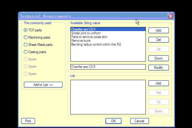

pBe Posted April 6, 2015 Posted April 6, 2015 Ok another question. So, I thought of using shortcut buttons. When I click the button "MACHINING PARTS" these string" Parts to remove oxide skin..." .....will automatically added to the list When the user pick mech or cast, the list under "library" will be appended with the the other set of strings ? so whats the point in separating the ini files then? sort of like like what i said before. put all strings in one ini file. that way you dont need to modify the code. You understand what i'm driving at? Now, if the entire list would be replaced, then having different ini files would make sense. As for the pick button, when the user selects a TEXT/MTEXT/ATTRIBUTE, the value would appear on the edit box [you should give that a name as well btw ] between Library & List. ? It wouldn't be too hard to modify your code to do the latter. Quote
AIberto Posted April 6, 2015 Author Posted April 6, 2015 When the user pick mech or cast, the list under "library" will be appended with the the other set of strings ? so whats the point in separating the ini files then? sort of like like what i said before. put all strings in one ini file. that way you dont need to modify the code. Not appended . You understand what i'm driving at? Now, if the entire list would be replaced, then having different ini files would make sense. Yes,When user pick mech or cast button, entire list would be replaced. As for the pick button, when the user selects a TEXT/MTEXT/ATTRIBUTE, the value would appear on the edit box [you should give that a name as well btw ] between Library & List. ? Don't care this“pick” button , The default, The string is added to the library. This has no effect. Quote
AIberto Posted April 6, 2015 Author Posted April 6, 2015 The process is like this: First, I need add what I need“string” to list , and save. this may need to choose save to where . mech? cast? or sheet ? When I click the button "mech" ,Clear List and read mech.ini file , Written to the List. At this time. I can click "ok" button Insert the string to the drawing. Or continue to add other items from Library ,following can save again or insert to the drawing. Quote
pBe Posted April 6, 2015 Posted April 6, 2015 Not appended That is what your wrote on your previous posts AIberto So, I thought of using shortcut buttons. When I click the button "MACHINING PARTS" these string" Parts to remove oxide skin..." .....will automatically added to the list Yes,When user pick mech or cast button, entire list would be replaced. Now that makes more sense. . You may need to add the default string list to the "commonly used" column Don't care this“pick” button , The default, The string is added to the library. This has no effect. Then what is this for? The "pick " button is Select the Text from drawings , added to the library I will ignore the use of that kind of tone for now AIberto, I will take that as "frustration" from your part. All i'm doing here now is clarifying your requirements. Quote
AIberto Posted April 6, 2015 Author Posted April 6, 2015 That is what your wrote on your previous posts AIberto Now that makes more sense. . You may need to add the default string list to the "commonly used" column Then what is this for? I will ignore the use of that kind of tone for now AIberto, I will take that as "frustration" from your part. All i'm doing here now is clarifying your requirements. Sorry.My English is very bad. I don't have a clear explanation . Can you understand my post in the #15 ? Quote
