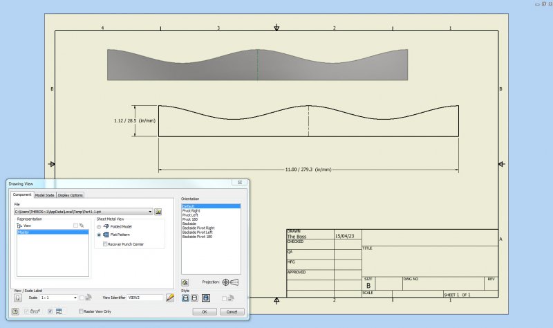

I'm doing a work prepartion of a pipe, and when i do the flat pattern i measure the piece and it gave me 279mm.
When i print, with a 1:1 scale, i measure in the paper and the flat pattern is 269mm.
I sent you the drawning for us to see what happend.
Wish your's help.

I downloaded your file and checked it out. Apparently, the flat pattern can not be printed directly from the flat pattern part. I think the part (.ipt) must be placed in a drawing. Note: before dropping the view in the drawing, select the Sheet Metal View - Flat Pattern option.
Once in the part is placed in the drawing (*.dwg), the file can be printed in full scale. When I printed the file, I obtained the 279.3mm length, same as what was dimensioned in the flat pattern part. I had also tried printing from the *.ipt file directly and the measured results were significantly off.

To keep things simple, the following dialog assumes that only ONE file is open... the sheetmetal part you wish to print... (it doesn't matter if you are viewing the part as a folded model or a flat pattern).

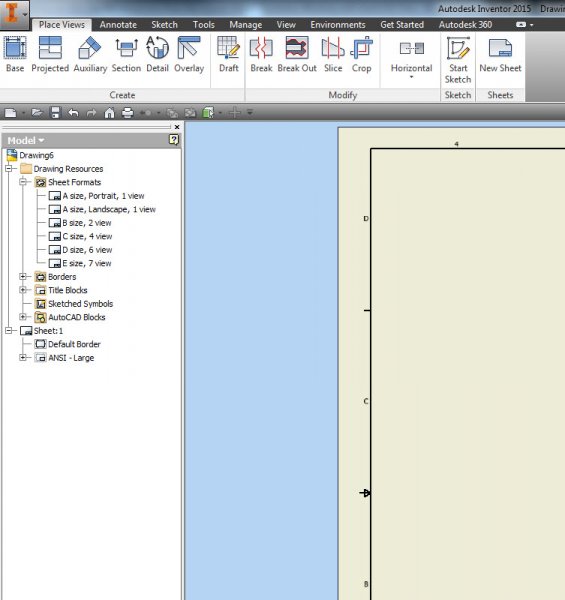

Open a new drawing. Doing so changes the ribbon menus for working with drawings.
Place your part by clicking on "Base" in the place views tab on the ribbon. When you do this, two things happen:
1) a Drawing View dialog box opens
2) a preview of the part appears and is attached to your cursor.
BEFORE clicking anywhere else... place your cursor in the Drawing View dialog box.
1) Notice that the scale is set to 1:1 by default (if your sheet size is larger than the part... more on this later).
2) Select the "Flat Pattern" button located under the Sheet Metal View section.
Now, you can move your cursor to an area on the drawing sheet to place your view of the flat pattern.
In your case, since this part is 11" long, you may want to consider using a larger sheet size to print the full scale pattern. Notice that the attached Drawing View.jpg file depicts the dimensioned part placed in a B size drawing.
