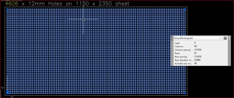

Here is a question.... if i have a sheet size of 2350mm by 1150mm and want to place 4613 12mm diameter holes in rows with even spacings is there a way to do this in autocad???

The rectangular array command cannot do it with an odd number of objects, unless they have a hidden way to vary the count and spacing in every other row or column, that I don't know about. I already hurt my head doing math for this.:shock:
The attached drawing is as close as I could get with an odd number of holes and straight even spaced rows and columns, which will fit in and fill up the given space. I 'sploded and erased the extras.

12mm holes 2mm edge gap = 13527 holes so plenty of scope to play with, that took about 15 seconds to do, just pick a spacing and use Array

I understand full well that this is not exactly what you asked for, but it is in the Rectangular Array ballpark.

what number of rows times what number of columns would yield 4,613 holes?
It won't happen with an odd number of objects in a rect. array.
Is there an array option where one can enter total count? Hey, array path does that, come to think of it. Just establish a ziggy zaggy continuous pline path at the right spacing and it may work. I'll have to try that. It'll be a cool parlor trick.

Yeah, that's what I was alluding to in post #7, but it is not exactly intuitive, particularly quick nor easy.
With that technique you could get the number of holes easily, but the spacing would be uneven, although it would look very nice and neat.
