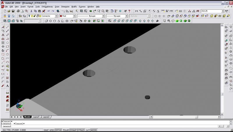

Mark_Anif Posted April 10, 2015 Posted April 10, 2015 Q1: how can i remove or delete the hole that i have already union objects into one? any others command related to this problem.. see attachmnt below . Quote
rkent Posted April 10, 2015 Posted April 10, 2015 (edited) Hold Ctrl down, pick the wall of the hole, hit delete. Edit: I didn't notice the OP is using r2000, Ctrl key probably didn't work back then, so follow other suggestions offered. From the command line, Solidedit, Face, Delete,... Edited April 10, 2015 by rkent Quote
Dadgad Posted April 10, 2015 Posted April 10, 2015 (edited) I have never used Autocad 2000, but in newer versions you would find the commands you are looking for on the SOLID EDITING toolbar. Whatever you do, don't use any of the Purge commands when doing this. Rkent, Ctrl selection cycling, another good one to remember, of which I have never taken advantage! Edited April 10, 2015 by Dadgad Quote

hoss Posted April 16, 2015 Posted April 16, 2015 In order to get rid of the holes, you can draw a circle at the base of each hole, extrude to the thickness and union Quote
Mark_Anif Posted April 16, 2015 Author Posted April 16, 2015 thank sir. i already tried it. its look like perfect when we it in shade view.. but when we view it in wireframe,its still shows new line circle that already extrude. how to fix it sir? Quote
ReMark Posted April 16, 2015 Posted April 16, 2015 That could just be your leftover 2D geometry. Try erasing it using a window rather than trying to pick it. To create 2D views of your 3D model you have but two options. 1) SOLPROF 2) Combination of SOLVIEW and SOLDRAW This article from Cadalyst magazine, dated 1-Dec-2000, explains both methods. http://www.cadalyst.com/manufacturing/back-to-2d-10167 Quote
ReMark Posted April 16, 2015 Posted April 16, 2015 There is another option but it will depend on whether or not you'll be doing more of these types of drawings in the future. It is a program called Flatshot Pro created by a company called nyacad. Here is a brief description of the program. Flatshot Pro application designed for automatic creation of 2D drawings from AutoCAD 3D Models. The program is more efficient than regular Soldraw, Solprof or Flatshot (AutoCAD2007 or higher) AutoCAD commands and compatible with AutoCAD2000 or higher. Flatshot Pro comes included in a program called ACAD Officer. There are two versions of this program the second of which is called ACAD Officer Light. It sells for $120 U.S. For further information click on the link below. http://www.nyacad.com/index.html Quote
hoss Posted April 16, 2015 Posted April 16, 2015 thank sir. i already tried it. its look like perfect when we it in shade view.. but when we view it in wireframe,its still shows new line circle that already extrude.how to fix it sir? Not sure if this works on 2000, but you can try BREP, should clear it Quote

Cad64 Posted April 16, 2015 Posted April 16, 2015 Not sure if this works on 2000, but you can tryBREP, should clear it BREP was introduced in 2007: http://knowledge.autodesk.com/support/autocad/troubleshooting/caas/sfdcarticles/sfdcarticles/New-and-changed-commands-in-AutoCAD-2007.html As ReMark mentioned, it's probably just leftover geometry, and if that is the case, the only command needed is ERASE. Quote
SLW210 Posted April 16, 2015 Posted April 16, 2015 Could also be the part used to fill in the hole was slightly smaller when you unioned. Post the file and we can have a look. Quote
