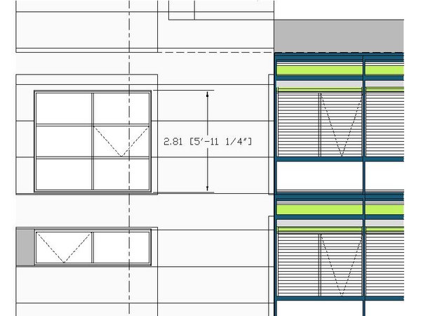

muaddib Posted February 22, 2007 Posted February 22, 2007 I have to ad dimensions to an architectural drawing in model space The file is drawn in decimal units (1unit=1meter) Now I have been asked to ad dimensions in feet and inches to the drawing in order to make it usable to UK I know that the solution is to use alternate units with Architectural units format, but how mach is the multiplier that I have to use? I have no experience in British metric system. So I left the multiplier 25.4 as AutoCAD prompt. Can anyone please inform me if is correct? 2.81 meters equals to 5'-11 1/4” ? Thank you in advance Ps. I’m using AutoCAD 2007 Quote

the ber Posted February 22, 2007 Posted February 22, 2007 2.81 m x 39,37 " per m = 110.6299 " 110.6299 / 12 = 9.2192 ft. .2192 x 12 = 2.63 9 ft. 2 5/8 " Quote
lpseifert Posted February 22, 2007 Posted February 22, 2007 As per the ber 1 meter=3.28084 feet Quote

muaddib Posted February 23, 2007 Author Posted February 23, 2007 So I just enter the multiplier value equal to 39,37 and automatically the annotations have both decimal and architectural system. Thanks everybody Have a nice Weekend Quote

SanMiguel Posted December 20, 2012 Posted December 20, 2012 So I just enter the multiplier value equal to 39,37 and automatically the annotations have both decimal and architectural system. Thanks everybody Have a nice Weekend thanks for this tip...very usefull ive been banging my head for a while on what would be the correct multiplier to use....ive tried 3.28 but its still giving me wrong dim.....how the heck did you get 39.37 as a multiplier??? Quote
the ber Posted December 20, 2012 Posted December 20, 2012 there are 39.37 inches in a meter. 1000 mm divided by 25,4 mm/in = 39.37 in Quote
