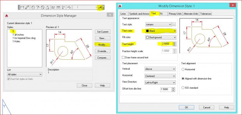

Hello, I'm working on a PF Oleson subdivision project, and am on the dimensioning stage, and cannot get the text to show up on the dimension line. I feel i must have turned something off. Can anyone help with this?? Thanks.
Welcome to CADTutor. :)
You should open the dimstyle dialog, click on MODIFY and check the color and text height on the TEXT tab.

During the text style modification, on the TEXT tab, you might want to set your TEXT COLOR to , which means that it will be displayed as either white or black, depending on the color of the background, so as to be visible wherever it is displayed.

I meant to set the text color in the dimstyle manager, not in the properties for the text.
