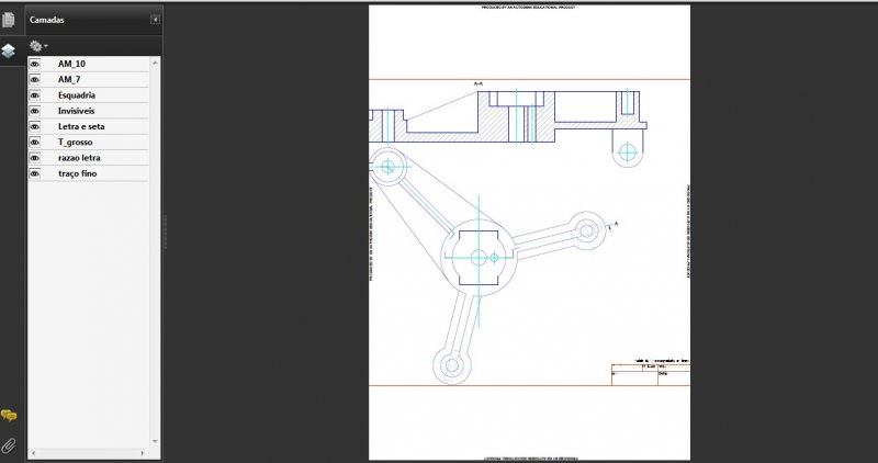

Hey guys. I am trying to plot a A2 sheet, DWG to .pdf. I want the sheet to be on horizontal orientation. then, i choose (594x420). The problem is when i finished the plot the pdf still admits the vertical orientation. How can i fix this? I need the plot to be in 1:1 scale, not fit to paper... thanks

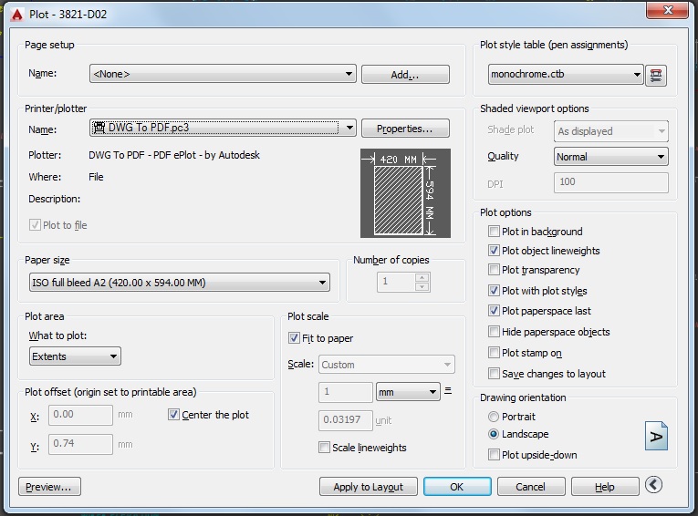

What does your page setup manger layout look like?
Are you setting up in paper space?
what size have you drawn your viewport window?

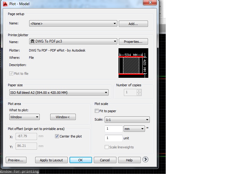

i drawn a rectangle with 594 x420 and i pick 'window' to select that rectangle... that's because i dont know how to work with the layouts ... i just work with the model sheet. the right column of your attachment does not appear in my plot command... i dont know why...
If you click on the > next to help and make sure your drawing orientation is set to landscape
