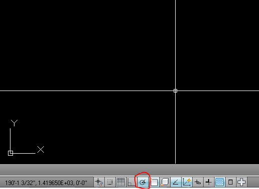

Hope I'm wording that correctly. When I select a line and then place the cursor of one of the grips (blue icons) on the end of it, I'm used to seeing the length and the angle of it showing up. That is no longer happening. I thought that was called polar tracking...???
Polar tracking happens when you select the grip (blue icon) and change the location of it. It can do it in relation to the current location or in reference to another point.
Yes, but somehow it got turned off. How do I turn it back on. F10 has no affect whatsoever on it.
Right click on the Polar Tracking button and check the settings:
Okay, finally found it. The "Enable Dimension Input where possible" button was not checked in the Dynamic Input tab of the DSETTINGS.
