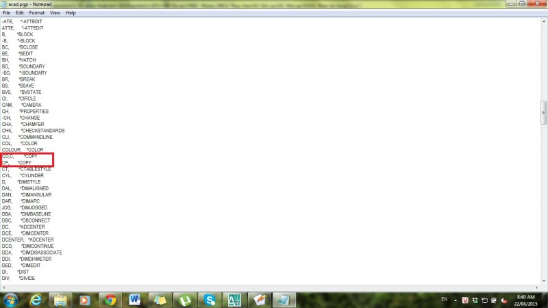

chienpham Posted April 22, 2015 Posted April 22, 2015 Hello everyone, I'm a newbie in our forum, and I'm from Vietnam. I've got a problem: Some shortcut commands in my Autocad 2007 are missing. For example, I have to type cp ( instead of Co, or C) to copy an object. I have tried to edit the acad.pgp file but it's not working. Please help me. Thank you so much Cadtutor's members! Quote

chienpham Posted April 22, 2015 Author Posted April 22, 2015 (edited) Dear Dadgad Please download this pic if you can't see it in thumbnail, thank you so much for your support Edited April 22, 2015 by chienpham nope Quote

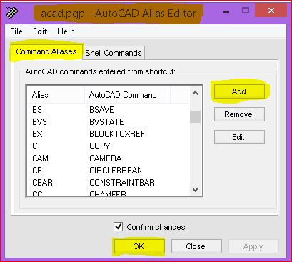

Dadgad Posted April 22, 2015 Posted April 22, 2015 (edited) If you want to customize any shortcalls, the correct place to do it is a the very bottom of the list, you will see instructions there, and any that you enter in the correct area will override the ones on the OOTB (out of the box) list. I will post a screenshot in a couple minutes. I am not sure if the command ALIASEDIT is available in Autocad 2007, but if so, you can change them there quite easily, on the fly without needing to open the .pgp file. Edited April 23, 2015 by Dadgad Quote

Dadgad Posted April 23, 2015 Posted April 23, 2015 (edited) Thank you @Dadgad, but it's not working. I've edited the command in the bottom of the list, restart autocad, but nothing happened. Can you show us what you have done? A somewhat larger screenshot please, as you won't need to show very much in it. Frame it like mine, so that we know that you have done it in the User Defined Alias area. Did you try the ALIASEDIT command? Or is that the "IT" which you say is not working? I researched a bit, and it was an available Express Tool in 2007, so you should have it, if Express Tools are installed. After modifying your .pgp, you don't need to restart Autocad, you can use the REINIT (for reinitiate) command instead, it is quicker. Edited April 23, 2015 by Dadgad Quote
Dadgad Posted April 23, 2015 Posted April 23, 2015 Did you do it just like shown in my screenshot? C, *COPY That is the correct formatting. I just noticed that in your first screenshot you added C, after CO, (CO,C,) which is NOT how it is done! Let alone that it was in the wrong place, you should only put one alias on a line. Come to think of it, the software may now think that "CO,C," is your redefined shortcall for COPY. Go back into that upper .pgp file, and remove the C, which you added to the original alias. If you are making changes in the .pgp file, and you do not SAVE them before closing and using the REINIT command, any changes will be lost. Quote

Dadgad Posted April 23, 2015 Posted April 23, 2015 (edited) OMG!!! I DID IT! HA HAThank you so much for your support, Dadgad!!!! ^^ As with most things in life, it is really quite simple, once you know how. You never confirmed whether or not, you were able to use the ALIASEDIT command? If you haven't already tried, please do, you will be very pleasantly surprised by just how simple it can be. Happy I could help you, don't stop learning. Edited April 23, 2015 by Dadgad Quote
chienpham Posted April 23, 2015 Author Posted April 23, 2015 I don't use Aliasedit command, "Come to think of it, the software may now think that "CO,C," is your redefined shortcall for COPY. Go back into that upper .pgp file, and remove the C, which you added to the original alias." That's the point! )), AutoCad think that CO,C is copy )). So i have redefined it. Thank you again Dadgad, I'll keep learning ACad!!. Quote
Dadgad Posted April 23, 2015 Posted April 23, 2015 (edited) There is no reason to be afraid to try ALIASEDIT. The only reason I mentioned it, is because it is a really easy way to do this. Much easier than venturing into the .pgp. http://www.mycadsite.com/tutorials/level_4/4-12.htm http://www.ellenfinkelstein.com/acadblog/tutorial-create-a-command-alias-keyboard-shortcut/ I was surprised to see that it already existed in Autocad 2007, as I thought it was only a few years old. Glad you are back on the tracks. Edited April 25, 2015 by Dadgad Quote
tombu Posted April 24, 2015 Posted April 24, 2015 I've been using it since it was added as a Bonus Tool in r14, much easier than editing the pgp file. Quote
