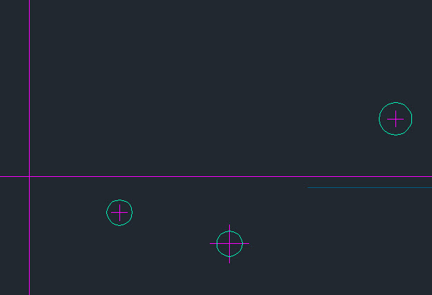

Is it posible to lock the objects in modelspaces?for example these three circles to that they can't be moved by accident when i edit other things. These 3 circles are vertical pipe reference for the real job site and it's critical that they are at the actual ref points. Thanks
You can't lock individual objects, but you can lock the layer they are on.
I have tried to make all of those circles in the same layer and lock that layer, works for me, that is good enough, it shows the little pad lock when i edit the circle. Thanks a lot.
You can use Geometric constraints and fix them in place.
Is that the pad lock icon found under then parametric tab on autocad 2015? i tried that one, the circle can not be moved but the center line of circle can be edited and diameter as well. nice to know more command thanks
