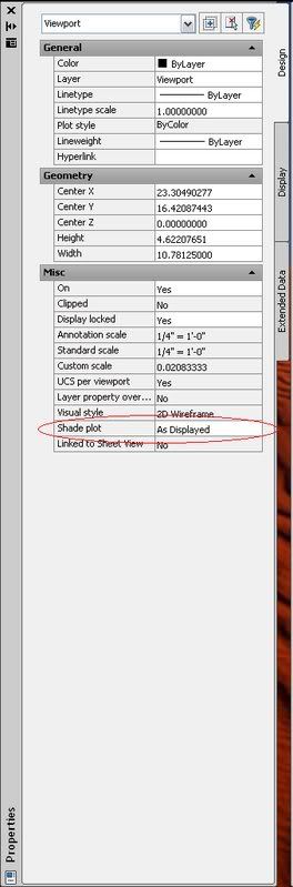

MaxwellEdison Posted December 18, 2008 Posted December 18, 2008 Plot style controls your color and lineweight assignments, useful if you want to print different colors by different linewights, but ultimately not what you're looking for. Select your viewport, right click and select Properties to open the Properties Palette (not the little Quick Properties window that 09 introduced) Under the Heading Misc (click the downward pointing triangle if nothing is shown underneath it) you should see the Shade Plot field I mentioned earlier. Let me know what it says.

MaxwellEdison Posted December 18, 2008 Posted December 18, 2008 Alright...start by typing PROPERTIES into the command line and hit enter. That should open the palette. Then highlight your viewport and look for the item I've circled below.

2kdesigner Posted December 18, 2008 Author Posted December 18, 2008 we're getting closer...excellent instruction! and thank you so much for your time. okay, this is the small box I was refering to before (my screen has a very high pixel count so what should be a normal size is sometimes not) I can get to this with the right-click option you mentioned. I was double-clicking the viewport putting me inside it. I've got that staight now. Unfortunately I'm not seeing the "Shade Plot" box. I have everything you do except Anno. Scale, Layer Prop., Visual Style, Shade Plot, Linked... Got any more ideas?
