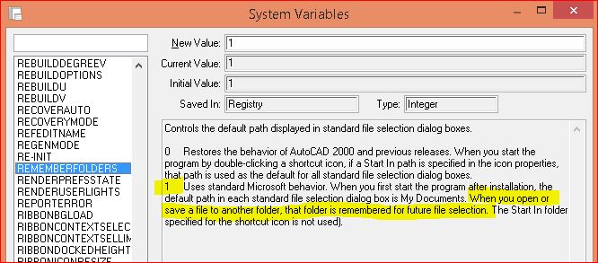

Starting last Thursday, when I want to open an existing drawing in v. 2011, the drop-down box no longer takes me to my project folder. Instead, I have to type in the whole address (c:\users\company\documents\projects\project name\etc...) in the command line. I have no idea how this got reset or how to get it back. This is a real nuisance!
How can I reset the path?
Try checking your REMEMBERFOLDERS variable, as shown in the screenshot from my SYSVDLG command.

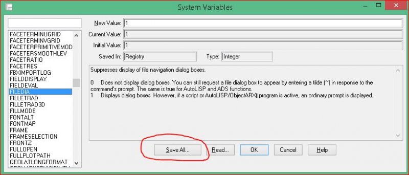

Did you mean the open file dialog? You can get it back by typing FILEDIA, enter, type 1 then enter.

Should Edwin be right, you might want to look at the screenshot taken from the SYSVDLG command.
It seems more likely this would have changed than Rememberfolders, if so it was probably caused by a poorly written lisp.
It is always a good idea to have SAVED an .svf (system variable file), for situations like this when something changes, and you don't know what or why.
In that way it is really easy to restore all of your custom system variable settings if something happens.
You can create such a file using the SAVE button at the bottom of the SYSVDLG box.

Thank you! That solved the problem.

By "that", do you mean the FILEDIA system variable?
Have you save an .svf file for yourself yet?
It is really easy, takes about 5 seconds.

Actually I did both:) First, I did the quick fix with the filedia command, then later I saved a .svf file.
