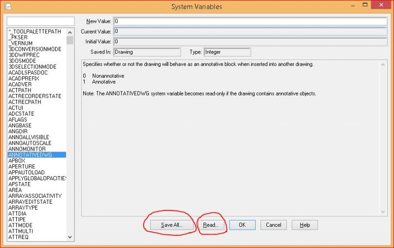

Are you familiar with the SYSVDLG express tool?
If not, then open it up and take a browse down the list.
If you use your cursor button you can scroll right through them, and eyeball them pretty quickly.
If you need to restore the default OOTB system variable settings, that i simple with the READ button at the bottom of the SYSVDLG box.
Otherwise, if you aren't an OOTB kind of user, I strongly suggest that you use the SAVE ALL button to create your own personal (easily recoverable)
.svf file with all your favorite settings, except of course for the one you are now struggling with. It also makes it easy to set up your system variable preferences
on another machine, or to share them.

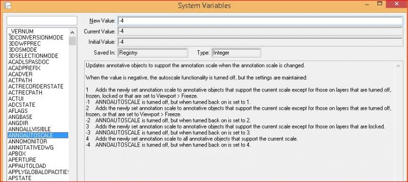

Does one of these ring a bell? Or MEASUREMENT?
