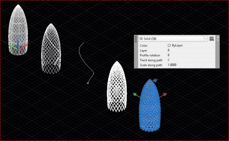

basty Posted May 1, 2015 Posted May 1, 2015 Can someone show me to create a 3D model of St Mary Axe using spline in AutoCAD? I know that it can be modeled by using revolve command. Quote

Cad64 Posted May 2, 2015 Posted May 2, 2015 (edited) I believe the OP wants to create a NURBS surface model. Here's a few links that might be helpful: http://knowledge.autodesk.com/support/autocad/getting-started/caas/CloudHelp/cloudhelp/2016/ENU/AutoCAD-Core/files/GUID-44020C98-A94C-42C9-976B-D032FEF014E6-htm.html http://knowledge.autodesk.com/support/autocad/getting-started/caas/CloudHelp/cloudhelp/2015/ENU/AutoCAD-Core/files/GUID-9EBC2243-B6BA-4A32-9300-8FAF15B2760F-htm.html And for anyone else who doesn't know, here is St Mary Axe: Edited May 2, 2015 by Cad64 Added Image Quote

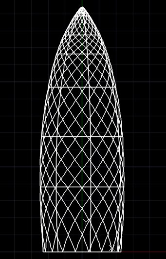

SEANT Posted May 2, 2015 Posted May 2, 2015 Are you trying to get the shaped helix as splines - such as this? SMC.dwg Quote
Dadgad Posted May 2, 2015 Posted May 2, 2015 Are you trying to get the shaped helix as splines - such as this? Nicely done SEANT, you certainly made that look easy! Nothing to fear but fear itself. Quote
SEANT Posted May 2, 2015 Posted May 2, 2015 Thanks Dadgad. Comparing the two again, though, it looks like my helices are too tightly wound. Oh well. If it turns out the objective of the OP was this type of geometry I might try again, to better match the image. Quote

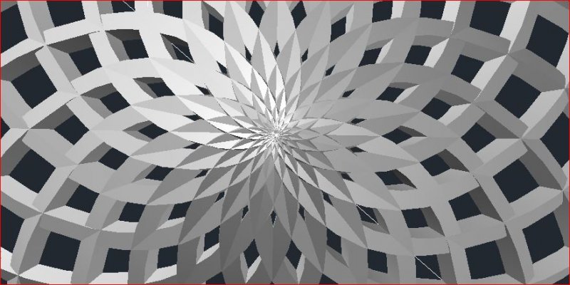

Dadgad Posted May 2, 2015 Posted May 2, 2015 (edited) Thanks Dadgad. Comparing the two again, though, it looks like my helices are too tightly wound. Oh well. If it turns out the objective of the OP was this type of geometry I might try again, to better match the image. Be that as it may, and you would know much better than I! But that didn't stop me from taking your nice effort around the 3D Solid modeling block. It ain't perfect, but lots of fun, having used that nice jumping off point you posted. Edited May 3, 2015 by Dadgad Quote
SEANT Posted May 2, 2015 Posted May 2, 2015 Nice. How large did the file become once you converted the geometry to solids? Quote
basty Posted May 2, 2015 Author Posted May 2, 2015 Are you trying to get the shaped helix as splines - such as this? Great model. Could you write here how to create it step-by-step? Quote

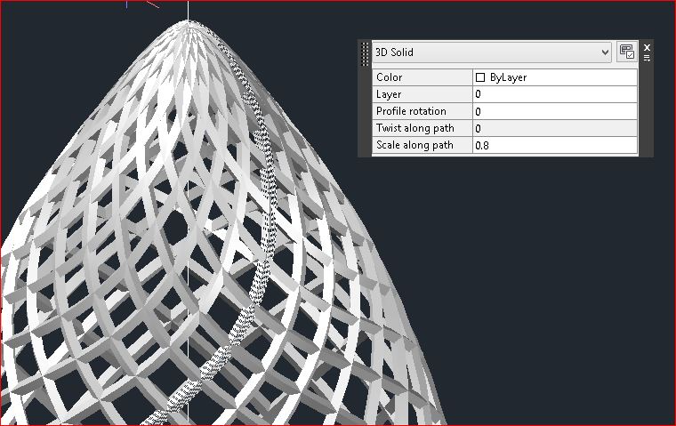

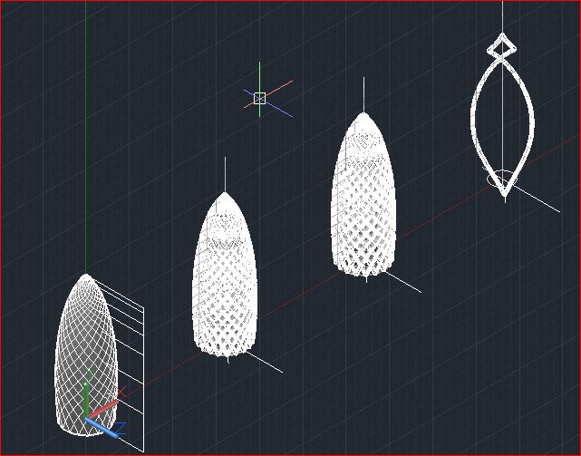

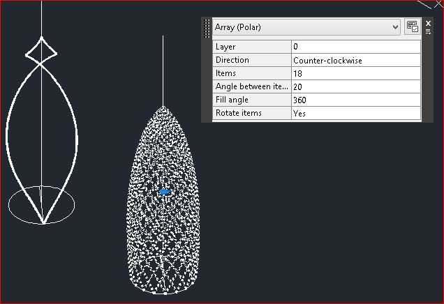

Dadgad Posted May 2, 2015 Posted May 2, 2015 (edited) Nice. How large did the file become once you converted the geometry to solids? Pretty big, more than 3mb. I used NCopy to drag out a spline, then swept a square rotated 45 degrees along it. Then I MIRRORed & ARRAYed that. I added a taper to the path swept spline, as shown in the screenshot, which makes it more realistic. Time constrained right now. It was too big to post. I posted the 3D Solid bit, ready to be ARRAYed, generated from SEANT's nice splines. This is finally small enough to upload. If it needs to be 3D Solids, the array can be exploded, but it certainly adds some weight to an already big file. Very interesting building design, highly energy efficient, the top floor is a bar, which looks to be quite a spectacular venue. Thanks for doing that SEANT! Glad you drew the Helix SEANT, as I tried and was unable to figure out how to do it smoothly, with a bulge in the middle. SMA Bits Only 2.dwg Edited May 4, 2015 by Dadgad Quote

Dadgad Posted May 4, 2015 Posted May 4, 2015 (edited) Basty in your other, St Mary Axe thread, I attached a drawing which was derived from the outstanding Surface Model which SEANT kindly posted. The drawing which I posted contains a 3D Solid generated along one of Sean's splines. If you open that, and follow my instructions, you too just might be able to do it. But if you don't TRY, it won't happen. Having spent a fair bit of my Sunday playing around with this, I am surprised & sorry to see, that you appear to have blown the other thread off. Have you returned to that thread? Or do you just post questions, to which forum members respond, and then walk away? I also included a short list of instructions in post#13 detailing how I created the 3D Solid shown in the screen shots, from SPLINES. Edited May 5, 2015 by Dadgad Quote
