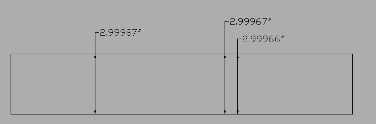

The object I wish to draw is 17" long & 3" diameter. I would like to show variations in the diameter at specific points of as little as 0.00001" at a scale or ratio that would be visible without using any zooms. Also, I would like to show the dimensions, leaders & arrows at a readable size. Perhaps 2 different views with different scales or ratios on the same drawing. Please help me step by step, thanks in advance.

Exactly what is it that you are needing to show (a picture would be helpful)
